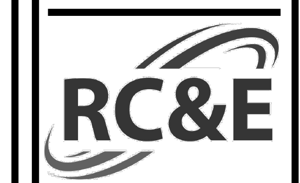

When I make a PDF from my DWG file I get these marks around my logo and my engineers seal. Can anyone tell me how to get rid of them. I'm using Autocad 2021.
It looks like they are the frames of images. You can remove them by setting the IMAGEFRAME variable to 2, which shows the frame but doesn't plot it.
If that's not the issue, please post a .dwg if possible.
I create all LOGOs, etc. as vector files. You might want to look into that as an option.
