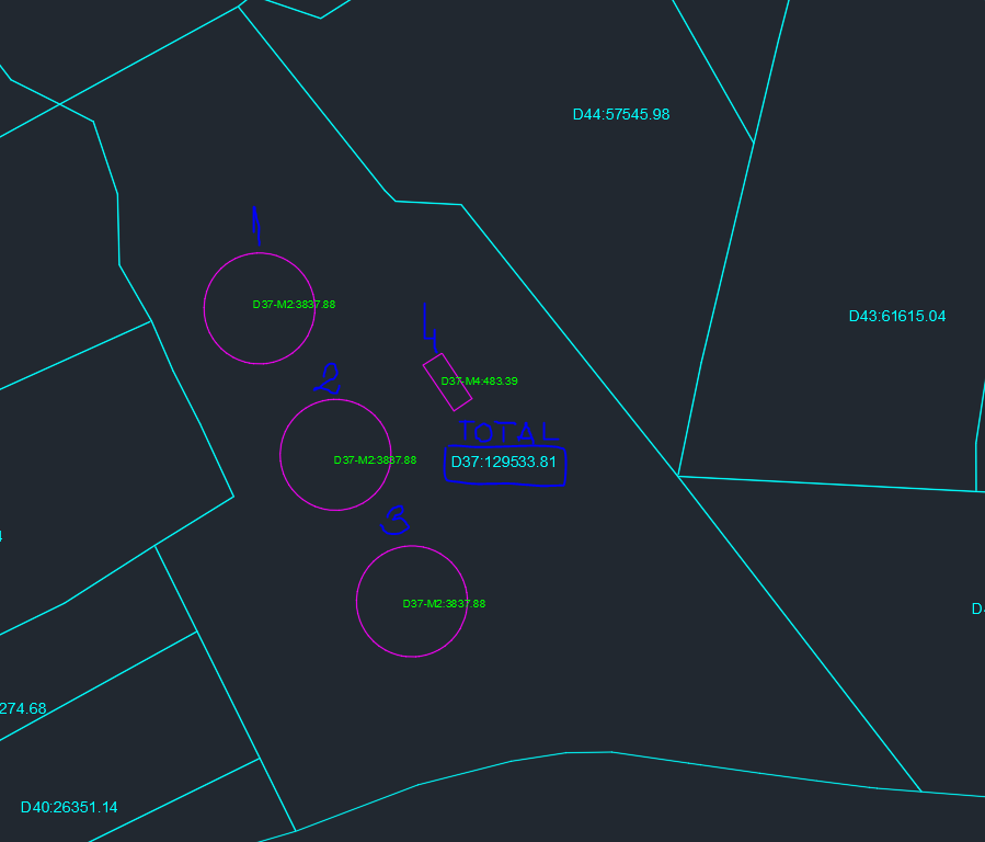

@PGia, I'v been updated my last code to get a total value of Area for the largest closed polyline.
@LanloyLisp, you'r lisp also works great.
But I'm afraid there is going to be complicated situation if @PGia going to have something like from this picture (I added this as possible situation):

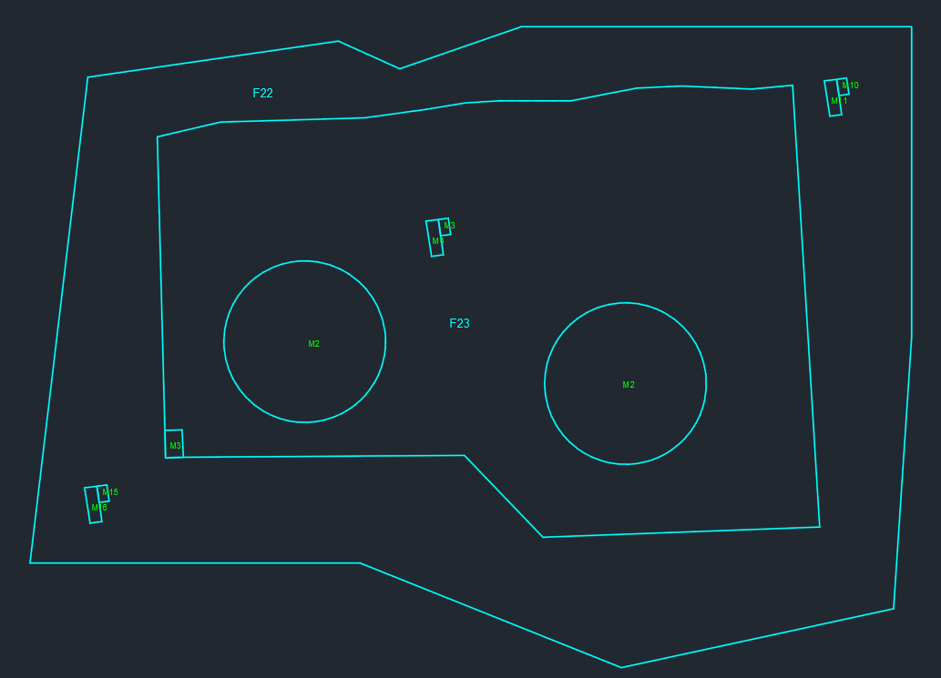

The real test I'm facing now is:  How do I apply these lisps to a drawing like the one I've attached? Is it feasible to try selecting 9,000 polylines, 1x1?
Edited by PGia

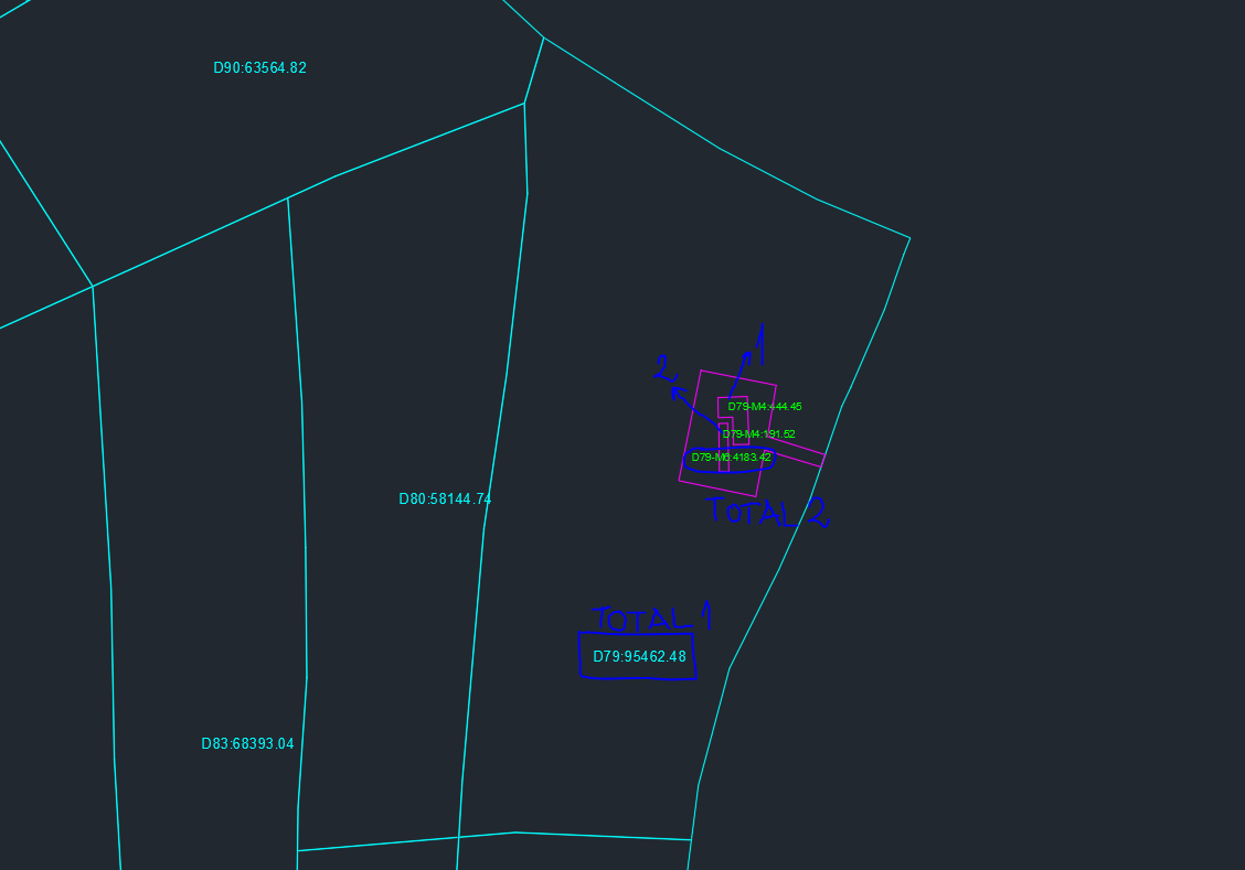

@GLAVCVS, just test it your code and it also works great 👍. I started something new to writte and didn't have time to finish it, when everything is going to be done and tested, I will also post it. Just a little notice @GLAVCVS (picture 1 and 2):
- picture 1: the  total  area need to be substracted from areas 1, 2, 3 and 4.
- picture 2: the  total2  area need to be substracted from areas 1 and 2, and the total1 area need to be substracted from areas 1, 2 and total2 (at this part I stopped writting the code).

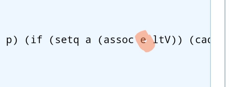

Thank you very much, @Saxlle.
Actually, getting that to work was the first thing I did.
But at the last minute, I made a change so the M tags would include a reference to the main polyline, and I didn't check it properly.
It's simply a matter of changing 'e' to 'p', as shown in the attached image.
I've already updated that in the code. Check if everything is correct now.
