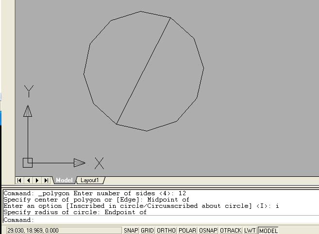

JamesP Posted April 20, 2009 Posted April 20, 2009 I have a question about accuracy. I am new to CAD. I have established six construction lines at 30 degree intervals all passing through a single point (20,10). These lines were to be the major axes of a 12 sided polygon (dodecagon). However, when constructing the polygon with a centre of 20,10 and a radius of 5 some of the apexes did not lie on the construction lines. Admittedly the error was quite small amounting to only about 2 or 3 mm in real world terms but would you expect AutoCAD to be absolutely spot on in such a construction? Frankly I can’t decide if it’s the construction lines OR the polygon that is in error or a bit of each. Perhaps it would be better to draw a circle of 5 radius then draw the polygon as a series of lines joining the point of intersection of the circle with the construction lines. Any thoughts? Quote

JamesP Posted April 20, 2009 Author Posted April 20, 2009 Now here’s a funny thing, I have redone the exercise and – guess what – the polygon was spot on!!! I haven’t a clue what went wrong previously. BUT- When I completed the polygon it insisted on placing itself with the apexes half way between the 30 degree lines, so the mid point of the flats were on the 30° guides. The only way I could get it to sit with the apexes on the 30° guides was to rotate it by 15° Have I missed some element in the construction of the polygon? Thanks for your help and watch out for me again – I am only on the foothills of the learning curve. Thanks again for your help. Jim Quote
Lee Mac Posted April 20, 2009 Posted April 20, 2009 I think this would depend upon whether you have it inscribed inside the circle or otherwise? EDIT: upon experimenting, you can rotate the polygon to whatever angle you like, upon drawing it. Quote
JamesP Posted April 20, 2009 Author Posted April 20, 2009 I tried it both ways Lee Mac. It made no difference - but it was more difficult to get the radius right when NOT inscribing! Thanks anyway. Edit: I ended up rotating it! - thanks Quote
Tankman Posted April 20, 2009 Posted April 20, 2009 Rotate the polygon as Lee stated. Whatever angle you require. Get going, not that difficult in any version of ACAD. Quote

eldon Posted April 21, 2009 Posted April 21, 2009 I have a question about accuracy.I have established six construction lines Any thoughts? Instead of drawing construction lines, draw one of the major axes. Then using the polygon command, you can draw your 12 sided polygon directly based on the mid point of the axis being the centre of the inscribed circle, and the end point of the line being the radius. Your polygon is now perfectly aligned without need for rotation Quote
