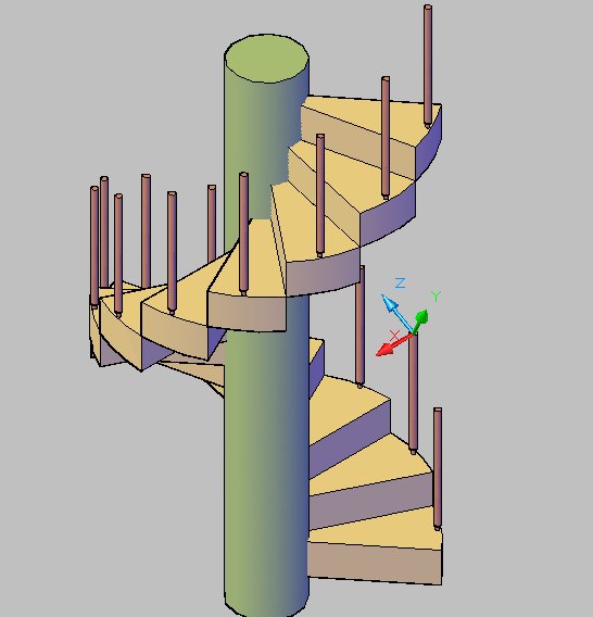

moz-screenshot.jpgI drawn a spiral stairs, in which i can't draw a horizontal railing.
pls help me to draw it....
Draw a helix throu the ends of the vertical bars and extrude a circle along it.
Your profile says that you use AutoCAD 2006 (nice image for 2006!)
In AutoCAD 2006 there is no Helix command but there a re a lot of Lisp routines helping you to draw one -you may searc the internet or even this forum, in the AutoLisp section.
Post again if you ned more help.
thats exactly the way i would do it as well. since you have a center snap point on each hand rail just use the SPLINE command and snap to each center point. Then draw your rail profile at the start of your handrail. EXTRUDE>Path.
Can you extrude along a spline? -Unfortunately I can not test it right now.
you can but there are restrictions with the ucs. I dont recall exactly what they are pre07. 07+ doesnt have an issue with it but i know ive done this in 05.

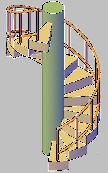

Ya....i did it...by spline...
thanks...shift1313
its cool to use spline command.
Nice! I can not wait to see the whole building! :)
thanks...shift1313
glad it worked out for you! How are you going to end the hand rails? some sort of decorative end? if you need to you can use the Solidedit>face>extrude and add a little extra to the ends. it will be a straight extrusion but it will allow you to trim off the ends vertical with your supports.
