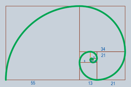

Lee Mac has interesting programs: Attractors, Fractals, Sierpinski Triangle...
Has anyone tried to build a Fibonacci sequence?
Representation of Fibonacci numbers in the form of squares with a side of the appropriate size.

53 minutes ago, Emmanuel Delay said:
It makes a spiral, but not the Fibonacci spiral exactly.
@Emmanuel Delay Thanks, the code creates a spiral at the origin of coordinates, but I'm interested in the possibility
of creating squares with corresponding sides... for example, up to 19 iterations...

Maybe something like this?

You should change "pol" to "_pline"
@GLAVCVS Yes, it's very good. Thanks!!!

@Nikon You should keep one thing in mind: the actual number of iterations will be 1 more than you specify.
I forgot to consider the first one, which is done before the loop.
Therefore, you should change 'repeat n' to 'repeat (- n 1)'

A slightly more complete version. Maybe it will be useful to someone someday.
It's very magical and visual!!!
