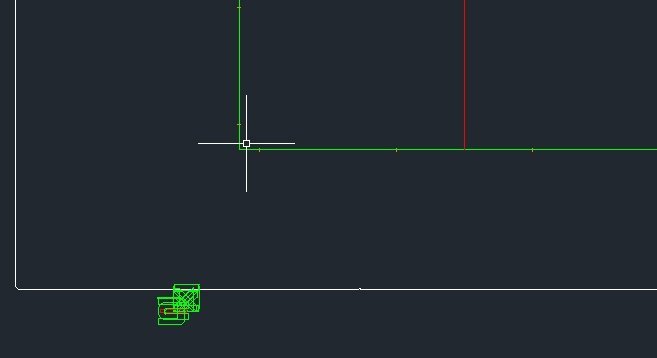

Hello everyone, my first post here.
I'm trying to do the following tasks:
1) explode blocks one by one
2) keep only hatch
3) generate hatch boundary (lwpolylines) one by one
4) explode the above lwpolyline into arcs and lines
5) overwrite the starting blocks with new blocks created by above arcs and lines (same name and position of the starting blocks) - - - > not implemeted yet: work in progress
6) erase all the other blocks
My code is doing the job but it stops every cycle and I have to press ENTER a lot of times to finish the job.
I suppose it's very easy to fix but I'm a beginner and I need some help.
In attachment a sample of dxf file I am working at.
p.s. sorry but english is not my native language.

Thanks for your comment: I have to convert in this way several drawings and, all of them, they are similar to the dxf attacched to my first post and they have got Region and Hatch objects after exploding the Insert objects.
Today, I've completed the code and it runs quite well to the end but there are 2 problems:
1) While the code is running, it shows sometimes "Unknown Command" but, despite the error,  it goes to the end accomplishing all the tasks.
2) After creating the new blocks, the line (command "._erase" ss "") doesn't work and it doesn't erase the exploded blocks step by step. The exploded blocks stay on the drawing to the end (pict in attachment) but I have to delete them in some way.
Any suggestion?

If at any time AutoCAD shows "Unknown command" it is likely that it has stopped processing some object.
Hi Marc
Is there any difference between the region and the new generated boundary? If not, just delete the Hatch and explode the region.
Here is an example that does this. The lisp works inside the block definition, so no need to recreate it.

Hello Stefan, thanks for your suggestion. I've tried to run your code but it prompts this error:
no function definition: STOCK:ACDOC
I am not familiar with Visual Lisp then I've re-written my code in order to explode the Region instead of the Hatch.
Now it works much better, thank you!!!
I've also managed to solve the problem to erase all the exploded blocks by including another erasing routine.
Marc
I corrected the code above.
Use it carefully. Based on your sample, I assumed that there is always a hatch and a region. If the region is missing, the result would be an empty block.
