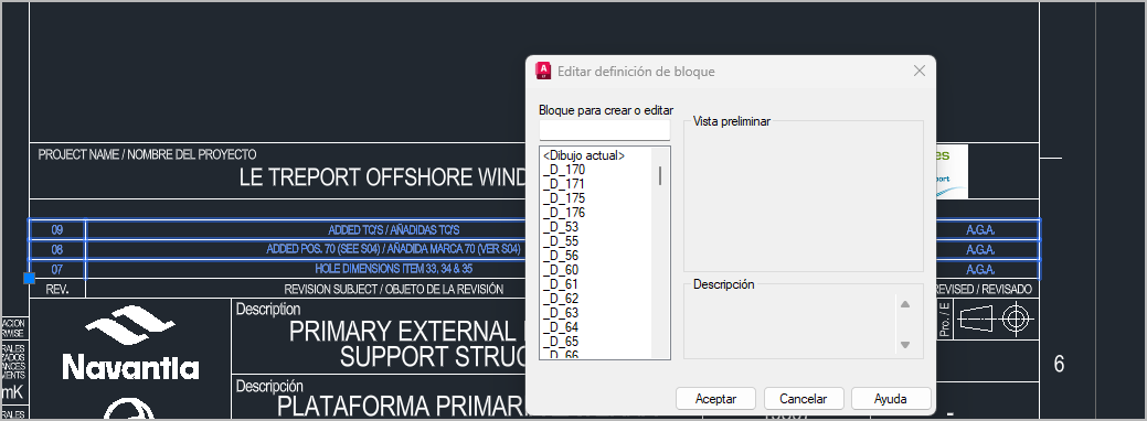

Everytime I do Ctrl + 1 to open the properties window everything I have selected gets deselected and it's getting pretty annoying. Any idea why this could be happening?
Edit: I have just noticed that when I double-click a block it shows the "Edit block definition" window instead of entering the block in edit mode.
And whenever I double-click a textM, it executes the command EDITTXTM, so I have to give it a third click.
I have no idea what is going on, I have some LISP routines but they haven't been causing any trouble in months.
