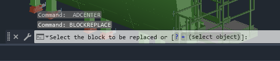

i have no selection window, i can not select any block,
Edited by jim78b
Have you checked the setting for implied windowing? It's in Options under Selection|Selection Modes.
Or look at your PICKAUTO system variable and see if it's set to 0.
THANKS i resolved set CMDDIA on(1)
Thank you for sharing your solution. Someone else may have a similar problem in the future.
yes for this reason i reply. thanks to you
