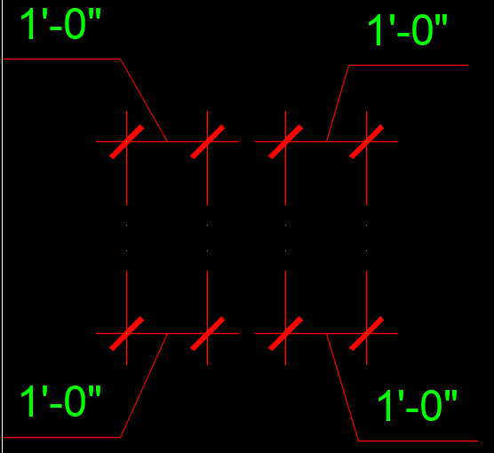

Does anyone have a LISP that will toggle dimensions with a leader into different quadrants?
When you do a dimension it will default to the position of the dim text, but you can override it and change the dim text point. So its a 2 step process. If you look at the 15 & 25 they have been moved.
What do you know about lisp ? This is sample code you would have 4 versions of this to move the dim text. So for me a dcl with choice orientation also.

I'm not at all good with writing LISPs. It is all Greek to me.  Can you write one that has the 4 functions in one LISP?
Ok I have something but I can not post, the move values for the dim text depends on your dimension style, so I need a real dwg so can work out these offset values.
Part 2 the code at moment links to the mid point is that OK, not sure have to dig deeper to see if can move it closer to an end.
Please post a dwg.

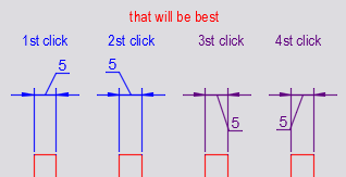

Is such an algorithm possible for this task?
Select dimension:
1st click on the dimension - dimtext moves along with the leader Top Left
2 st click                           - dimtext moves along with the leader Top right
3 st click                           - dimtext moves along with the leader Bottom left
4 st click                           - dimtext moves along with the leader Bottom right.
The offset from the dimension line should be equal to the height of the text (or two text heights).

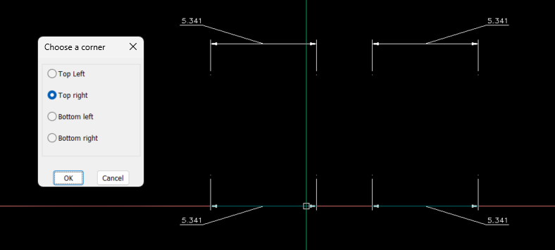

Multi radio buttons.lspGive this a try.
; https://www.cadtutor.net/forum/topic/97280-toggle-dimension-lisp/
; dim_sample.dwg move dime to one of the 4 quadrants
; By AlanH April 2025
(defun c:dodimcorner ( / ent obj dotl dotr dobl dobr)
(defun dotl ( / )
(setq tpos (mapcar '+ (cdr (assoc 13 entg))(list 0 dimsc 0.0)))
(vlax-put obj 'TextMovement 1)
(vlax-put obj 'TextPosition tpos)
(defun dotr ( / )
(setq tpos (mapcar '+ (cdr (assoc 14 entg))(list 0.5 dimsc 0.0)))
(defun dobl ( / )
(setq tpos (mapcar '+ (cdr (assoc 13 entg))(list 0.0 (- dimsc) 0.0)))
(defun dobr ( / )
(setq tpos (mapcar '+ (cdr (assoc 14 entg))(list 0.0 (- dimsc) 0.0)))
(if (not AH:Butts)(load "Multi radio buttons.lsp")) ; loads the program if not loaded already
(setq ent (car (entsel "\nPick a dim ")))
(setq entg (entget ent))
(setq obj (vlax-ename->vla-object ent))
(setq dimsc (vlax-get obj 'scalefactor))
(if (= but nil)(setq but 1))
(ah:butts but "V" '("Choose a corner" "Top Left" "Top right" "Bottom left" "Bottom right" ))
(cond
((= but 1)(dotl))
((= but 2)(dotr))
((= but 3)(dobl))
((= but 4)(dobr))
(c:dodimcorner)

This is great code, but Top Left and
Top right does not move the leader up.
Is it possible to sort through the placement options by clicking on the dimension (without using the dialog box)?

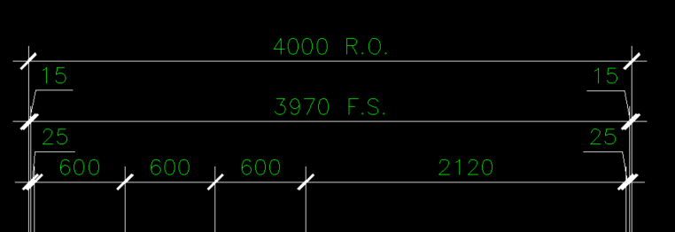

I refuse the dialog box, but I have to select the same size twice, then I can change the leader position in the loop by pressing lmb/rmb...
The problem with the top location remains...

Try setting (setq counter ... ) to 2 - I'm assuming here that the initial text position is top left, so when you click dimension to move it on, the first position change will be to set position to top left - the third click will move it on to TR.
  • Thanks 1
It doesn't change anything...
Probably, the program contains only these 4 positions of the text with the leader
depending on the distance from the dimension line.
Edited by Nikon
I dont know why its not working this is what I got just now copied code from here as an extra check.
There is some code out there for use arrows I will leave that for you to find.
