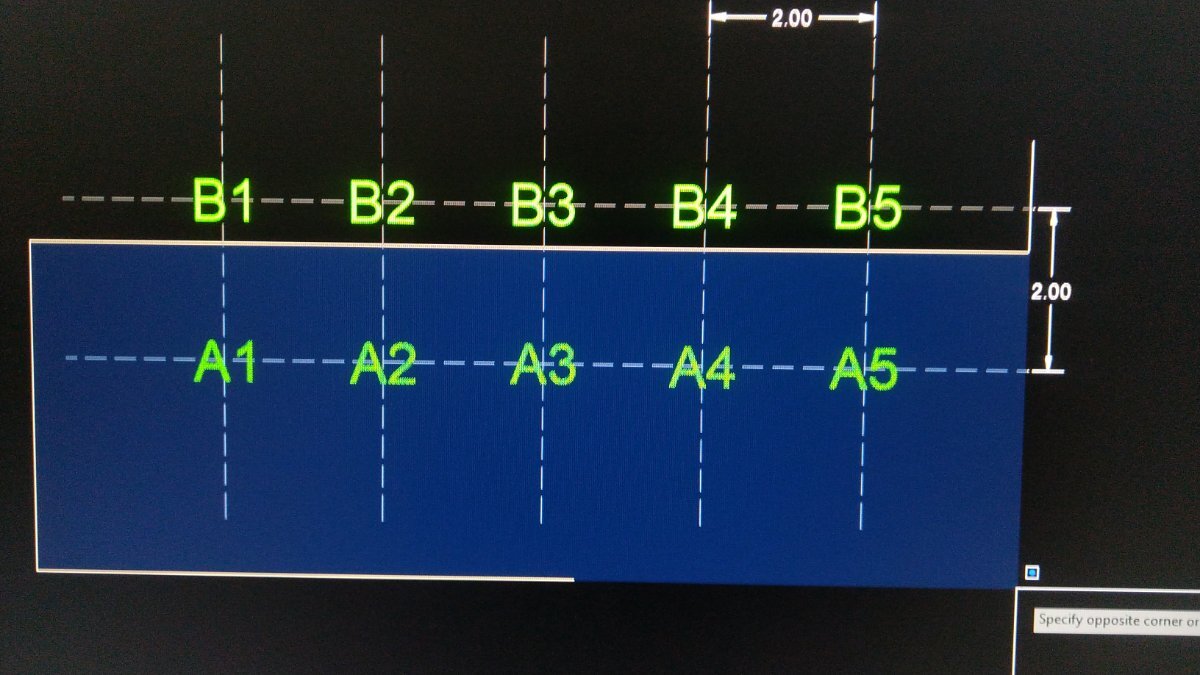

Dear Team,  Any lisp for incremental copy paste for multiple text selection.
If I copy text A1 to A5 and paste automatically add B, if I copy B series add next C,
If I am pasting continues then follow a, b,c...
See attached image
Thanks
