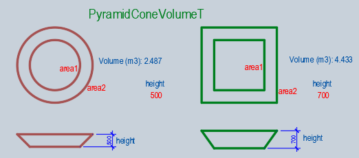

This code allows you to select the height of the pyramid by pointing to the text in the drawing.
How can I change the code to select a dimension in the drawing to use the dimension value
as the height of the truncated pyramid?

Hi
Replacing your function with this one... is that enough?
(defun getHeightFromText ()
  (setq ent (entsel "\nSelect the text object containing the height: "))
  (setq obj (vlax-ename->vla-object (car ent)))
  (if (= (setq to (CDR (ASSOC 0 (entget (car ent))))) "TEXT")
    (setq txt (vla-get-TextString obj))
    (if (= to "DIMENSION")
      (if (= (setq txt (vla-get-textOverride obj)) "")
        (setq txt (rtos (vla-get-measurement obj) 2 2))
        txt
      (progn (alert "No valid object") nil)
  (setq height (distof txt 2))

Here: your code modified to make it work.
But there's one problem: you haven't specified the volume calculations correctly.
I think I should leave this to you.

It works perfectly! Thank you very much!
I'll check the formula...
Edited by Nikon
If you hurry, you'll make people laugh...😀
I am replacing the formula string with
(setq volume (/ (* height (+ area1 area2 (sqrt (* area1 area2)))) 3))
The code now works like a Swiss watch.
