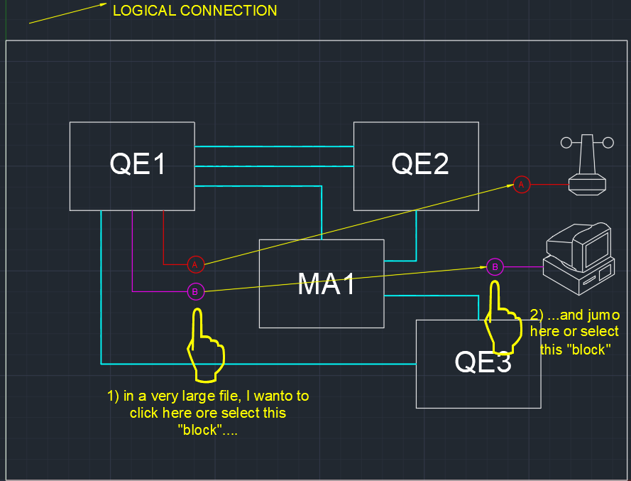

Good morning, often, in the circuit diagram of a P&DI it is inconvenient to have lines continue completely from point X to point Y.
It is convenient to "break them" and write a reference relating to where to see the origin or destination on the drawing.
Would it be possible to create an object or a block that allows this jump to be performed?
I attach a file to try to explain myself, I would like to connect the points A together and I would like to connect the points B together.
Thanks in advance
logical connection link jump.dwg
Here's a thought. Create a block with one or two invisible attributes. One attribute identifies the connection, and it may be visible if the connection itself has an identifier. The other attribute identifies which side it is. For each break, insert two blocks, one with an In attribute and one with an Out attribute, with matching connection IDs. You can use the ID of one side to find the other. If you're feeling adventurous, you can write some code to generate the ID and create the two blocks.

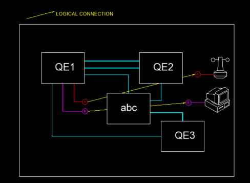

Like @CyberAngel I just made a block with an attribute and a wipeout. Just bring the attribute to front, using draworder.
Sorry, but I really don't understand how to do it? If you succeeded, can you attach an example file?

Can you elaborate on what you mean by "jump"? Would you click on one block and pan to the other? Would you select one block, press a button somewhere, and have the selection shifted to the corresponding block? Would you pick either side of the connection and have a line drawn from that end to the other? We can't give you a clear answer without understanding the question.
Exactly! I imagine it as a kind of link!

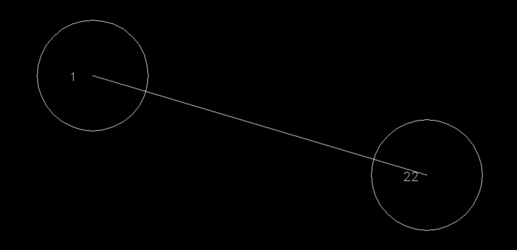

Ok if I understand correctly, pick say block "Terminal", attribute "Term"=1 draw a line to block "Terminal" but with attribute "Term" =22. So find the correct block. Is this what you want ?

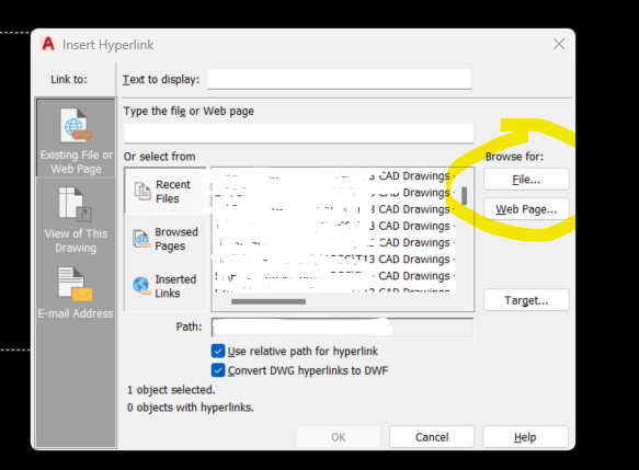

You can select the object (1) hit CTRL+K to open hyperlink. In the popup hyperlink window, click browse for FILE.
What I was suggesting is what you want, you have two blocks with an attribute value "A", select a block it gets the "A" and then you check all other blocks looking for attribute "A" and join, having the attribute tagname the same will help.
There was recently coding for getting the block info from mleaders, that would allow you to have one object rather than lines and a block.
If you post a proper sample dwg with a block & attributes, or mleader with the block, repeated say A B C D E  ie 10 objects. Then something may be able to be done.
