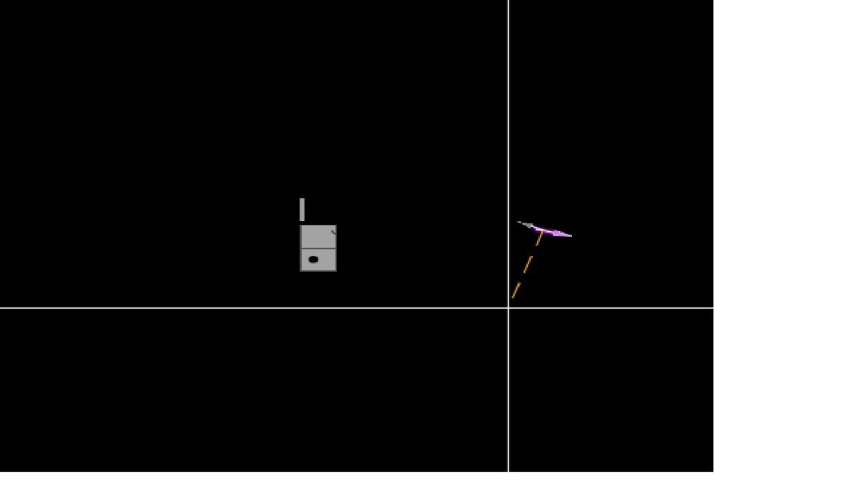

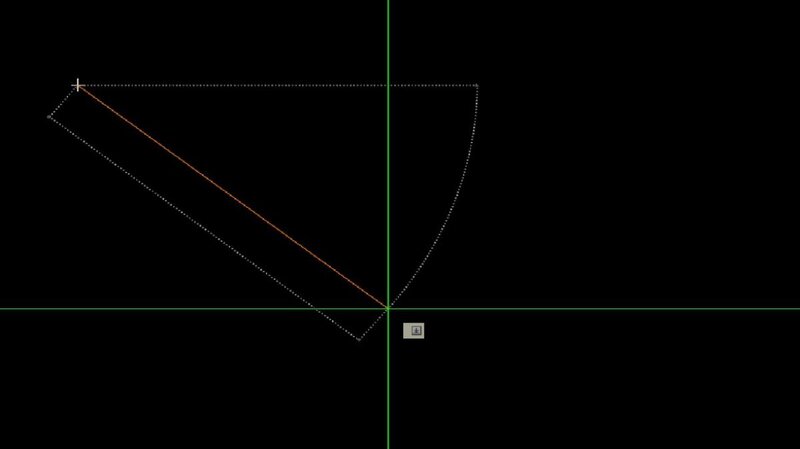

my menu line next to my cursor doesn't show the whole menu it cuts off 90 percent of what's supposed to be showing. for example when i run mirror command it will mirror but after i mirror it and it would normally ask if i want to erase source object yes or no, the yes or no doesn't show up here is a print screen of what I'm talking about its really annoying it only happened after i updated my AutoCAD from 2023 to 2025. and also when I'm doing a polyline it would normally show the length but it doesn't show anymore
 i have tried f12 for dynamic input i have tried dynmode changing from 3 to 2 to 1 . i have tried to adjust dynoprompt to 1 to 0 I'm at a complete loss.

What are your computer and graphics card specifications?
Work, home on a network, etc?
Could be a a bug or bad install.
If you're talking about dynamic input, you can adjust the settings for the input box. See this page. You can pull up the same window by using the DSETTINGS command and going to the Dynamic Input tab.
