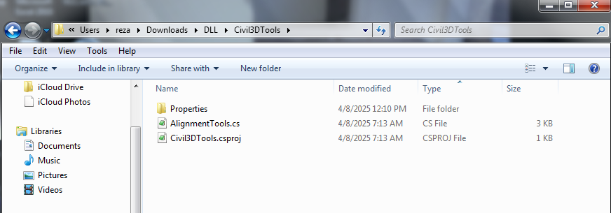

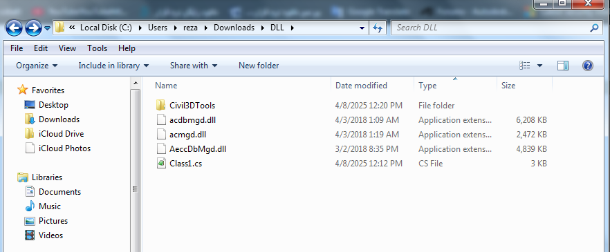

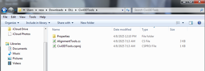

Dear Bigal:
I have been trying hard to do this with Visual Basic and C# for the past month (with help from ChatGPT).
but I have encountered many problems (numerous errors in Visual Basic and in generating DLLs in C#).
and it seems that this is not possible with Lisp either.
I would appreciate it if you, as a knowledgeable and experienced person,
could tell me whether I should give up on this project or not.

What exactly was the issue with the files in the .rar you posted at Autodesk Forums?
It has .dll files in it.
Thanks for your follow-up.
The zip file contains the DLL files in Civil 3d 2019 folder that are needed to generate the final DLL in the C# file written by ChatGPT.
