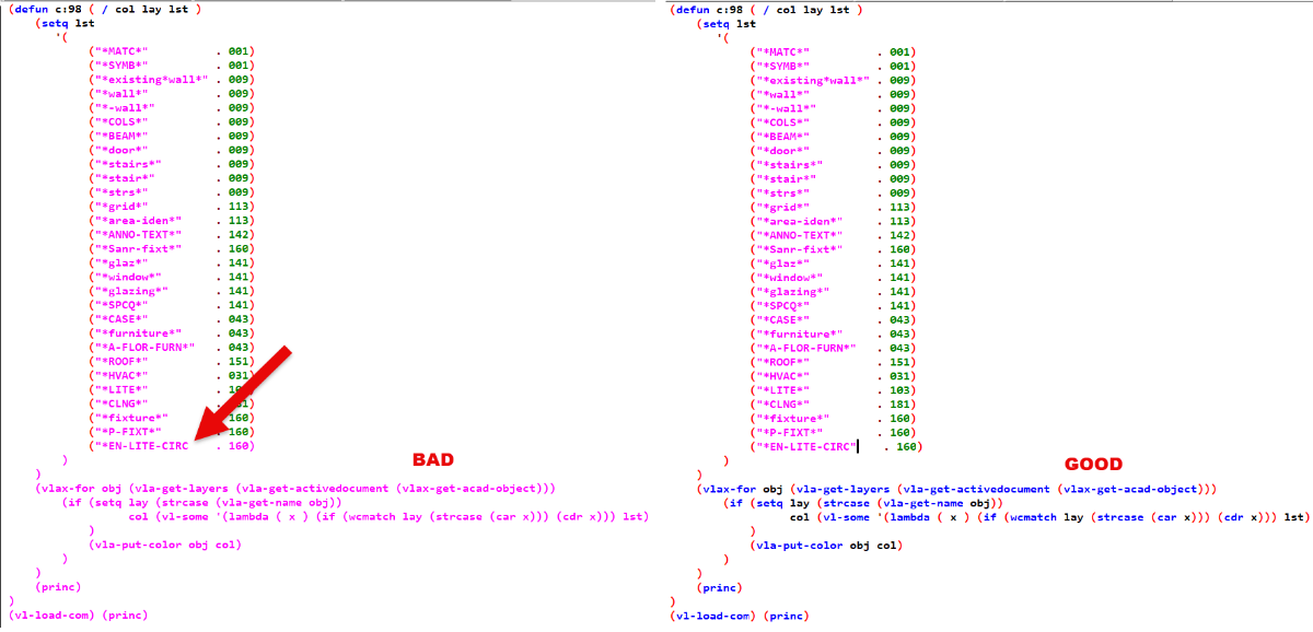

Efeezy Posted May 3 Posted May 3 (edited) I have had this scrip for years. I am running Autocad 2022 right now. I have been a mbemer on here for over 15 years I can not get in my old account Efeezy. Can someone fix this. I use it for my backgrounds. It cleanes everything up really fast. I run a script before this to change all the colors to red or what ever so evething I don't need stands out. I am glad this site is still here. ERROR WTF MAYBE MAKE NEW SCRIPT ----------------------------------------------- LAYCOL (defun c:98 ( / col lay lst ) (setq lst '( ("*MATC*" . 001) ("*SYMB*" . 001) ("*existing*wall*" . 009) ("*wall*" . 009) ("*-wall*" . 009) ("*COLS*" . 009) ("*BEAM*" . 009) ("*door*" . 009) ("*stairs*" . 009) ("*stair*" . 009) ("*strs*" . 009) ("*grid*" . 113) ("*area-iden*" . 113) ("*ANNO-TEXT*" . 142) ("*Sanr-fixt*" . 160) ("*glaz*" . 141) ("*window*" . 141) ("*glazing*" . 141) ("*SPCQ*" . 141) ("*CASE*" . 043) ("*furniture*" . 043) ("*A-FLOR-FURN*" . 043) ("*ROOF*" . 151) ("*HVAC*" . 031) ("*LITE*" . 103) ("*CLNG*" . 181) ("*fixture*" . 160) ("*P-FIXT*" . 160) ("*EN-LITE-CIRC . 160) ) ) (vlax-for obj (vla-get-layers (vla-get-activedocument (vlax-get-acad-object))) (if (setq lay (strcase (vla-get-name obj)) col (vl-some '(lambda ( x ) (if (wcmatch lay (strcase (car x))) (cdr x))) lst) ) (vla-put-color obj col) ) ) (princ) ) (vl-load-com) (princ) Edited May 3 by Efeezy2 Quote

BIGAL Posted May 4 Posted May 4 It may be as simple as delete these lines at start. I did not look any further. Add (c:98) as last line then it will run when you load it. ERROR WTF MAYBE MAKE NEW SCRIPT ----------------------------------------------- LAYCOL Quote

nod684 Posted May 7 Posted May 7 (edited) change this : ("*EN-LITE-CIRC . 160) to this ("*EN-LITE-CIRC" . 160) and if you want to keep this line ERROR WTF MAYBE MAKE NEW SCRIPT ----------------------------------------------- LAYCOL add a ;; before the line as bigal pointed out ;;ERROR WTF MAYBE MAKE NEW SCRIPT ;;----------------------------------------------- ;;LAYCOL Edited May 7 by nod684 2 Quote
ronjonp Posted May 7 Posted May 7 To add to this, if you had pasted the code into the VLIDE, the color coding is an easy indicator of the missing " since all the code at the end is color coded as a string. 1 Quote
