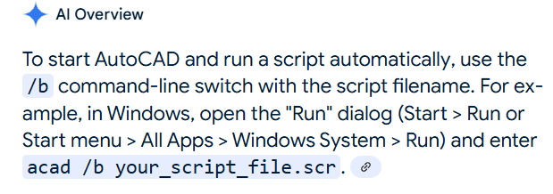

It is possible to open Autocad and run a script, Ok that solves one problem of your task the script has the zoom part. Now the bad news you need to write inside the script say a zoom c pt sc or use a ssget "X" to find the block and get its insertion point then do the zoom using lisp in the script.
No idea about the ACC.
Thanks, interesting idea, but won't work in my work environment. I think I might approach it from a different angle. Make a local library of all files and the I won't have to deal with the ACC.
