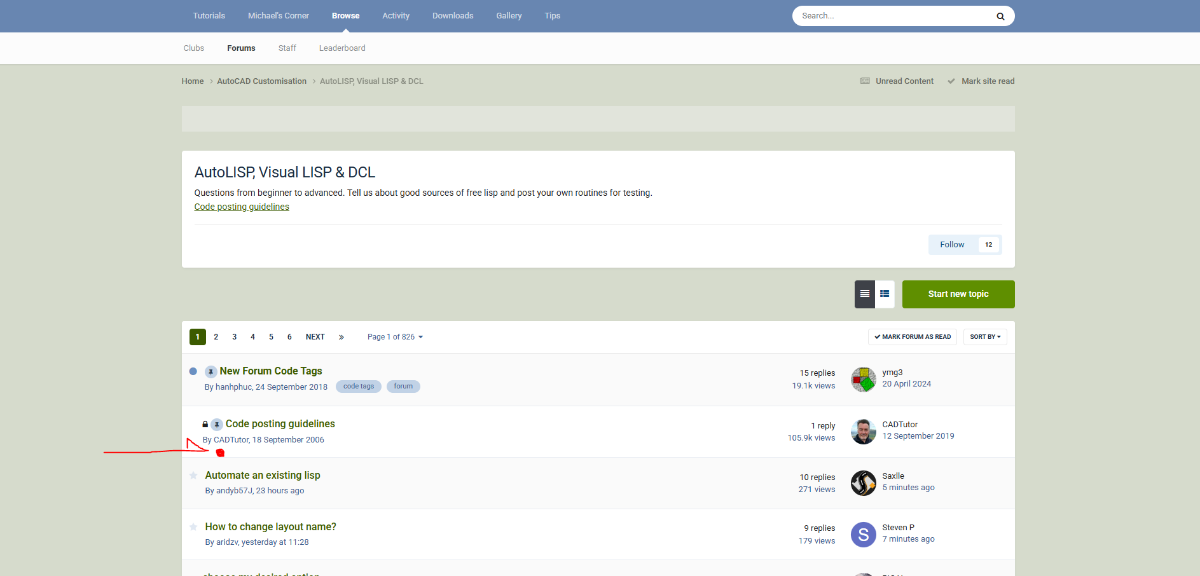

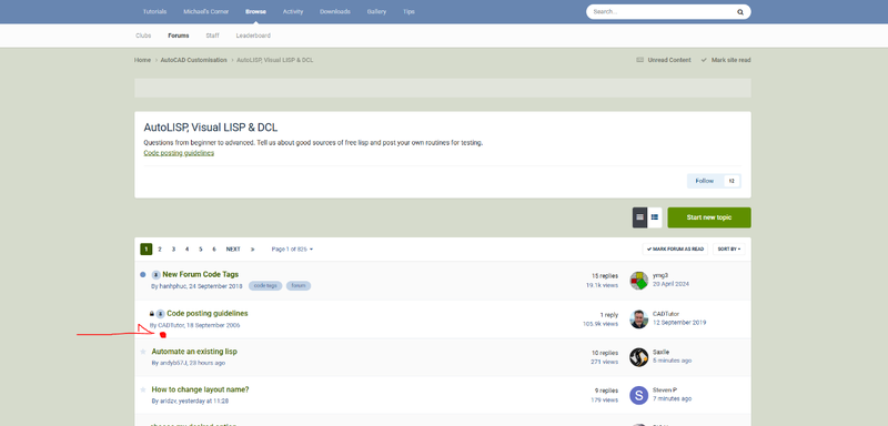

Saxlle Posted May 13, 2025 Posted May 13, 2025 Also, I saw it in some others threads, but don't know where to find it. 6 minutes ago, Steven P said: Often though for ease of programming I'll use what I know works, might be a little slower but if it saves me 10 minutes in programming and testing time I can usually run that LISP hundreds of times before any speed difference gains outweigh what I spent to make an easier LISP first off. Yes, absolutely agree with this. Maybe it would be great if moderators can make a thread where can all usefull things about programming in lisp can found in one place (for e.g. like from my previous post) and make it looks like from picture (like the "Code posting guidelines"). Quote
