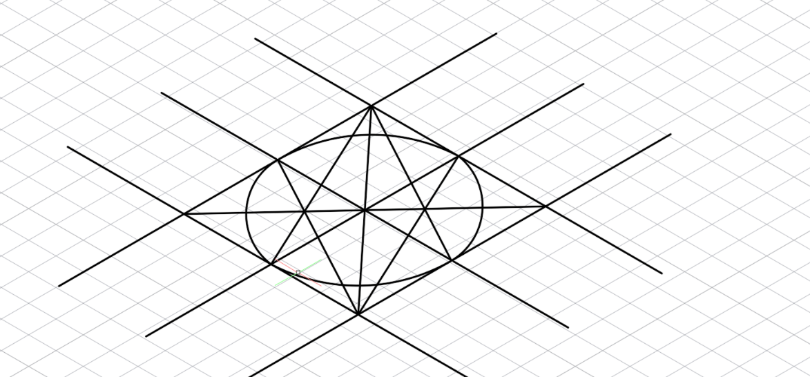

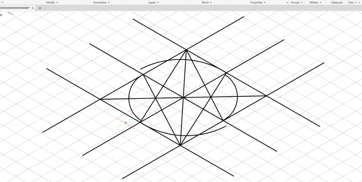

How can i fit the ellipse inside the rhombus as shown in the image? https://imgur.com/a/wPVzeXw
The ellipse isocircle just scales uniformly on all sides but how can i squish it at -30 degrees so that it will fit the rhombus, the rhombus is a rectangle in a normal view
It is not an Isocircle.

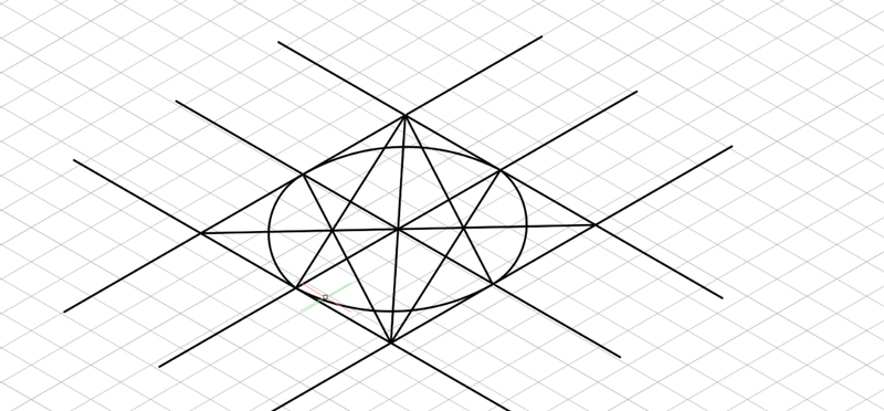

See if this works for you...
Thanks for the response
It worked very well, just had to rotate and stretch some arcs to make it perfect
