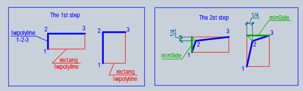

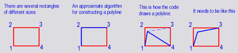

I want to get a polyline inside the selected rectangles to mark the hole.
Approximate algorithm:
Determine the lower-left, upper-left, and upper-right corner (or the corresponding points).
Calculate the offset (for example, 1/4 from the smaller side of the rectangle).
The offset point must be at the same distance from the left and top edges, i.e. diagonally inward
from the upper-left corner.
To build a polyline: lower left → offset point → upper right.
polyline for the holes.dwg

Please forgive my amateurishness...
I'm not really sure, but I don't think I need 2 defuns.
Why do I need to rotate the rectangles? defun rotate-rectang?
I just need to draw a polyline at points 1-2-3, and then offset point 2
down-to the right at 45 degrees by an amount equal to 1/4 of the smaller side of the rectangle.
I select several rectangles. Then a two-segment polyline is created in each rectangle.
Then the middle vertex of the polyline is offset.

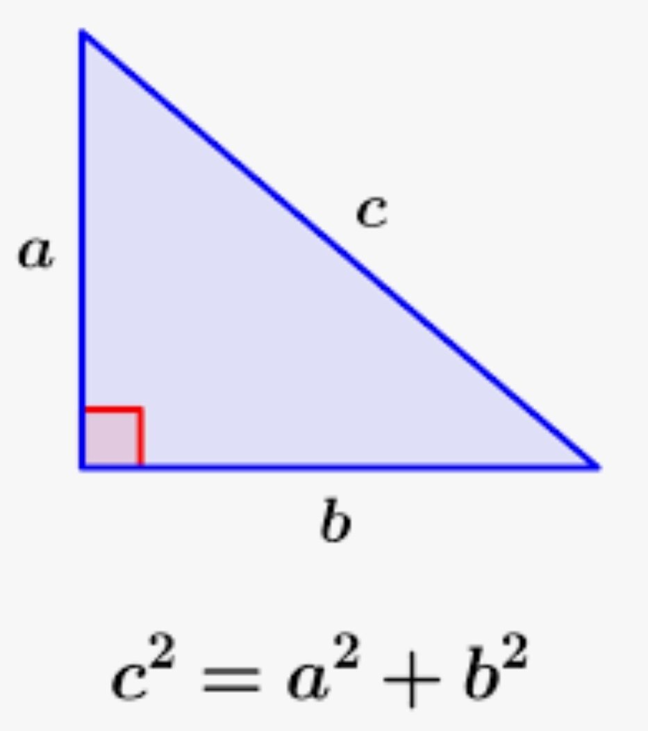

Hi Nikon
There's an important detail:
Are you sure the length of point 2 has to be shifted by 1/4 of the short side?
Wouldn't it be a little more, since it's the hypotenuse of a right triangle?

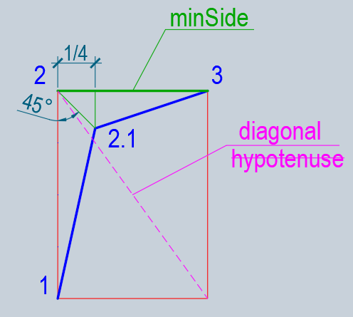

Hi @GLAVCVS
No, it's not related to the hypotenuse.
I'm drawing a line from point 2 at a 45 degree angle.
The intersection of two lines: a perpendicular to the smaller side at a distance of 1/4
from point 2 and a line at an angle of 45 degrees.
Edited by Nikon

Yes! It worked great! Huge thanks? Good luck!

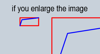

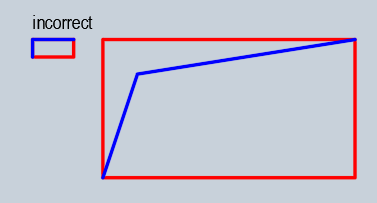

I've tasted the code @GLAVCVS a bit in Autocad 2021...
Sometimes the code doesn't work correctly, but if you zoom in and call the command again, the code works.
Edited by Nikon
It's probably OSMODE.
When the pickbox on the screen is as large as the polyline's movement, if the 'endpoint' object snap is enabled, then
(command "_pline" ...) it won't be able to avoid the OSMODE magnet.
But if you zoom in, the pickbox will be smaller, and the problem won't occur.
