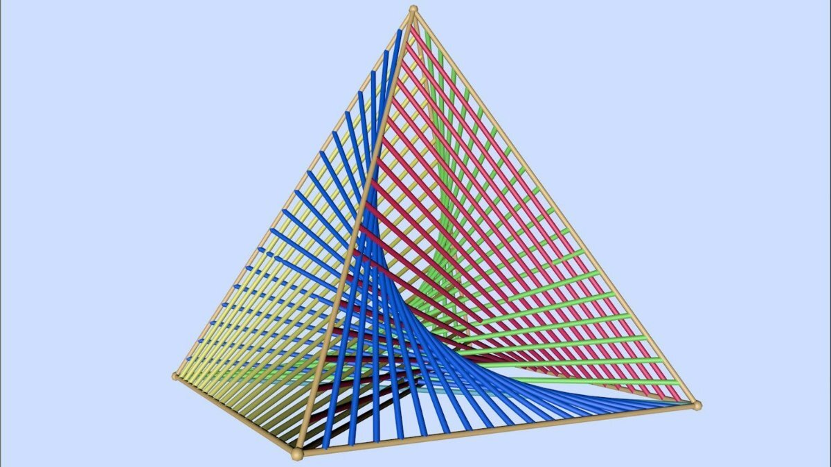

Hi Everybody,
I would like to draw lines within different plans, is it possible...if yes please guide me with some tips. i have an example in the attachment of what I pretend!
Thank you!
A line in a plane which you can get 3d points and a parabola in a plane again that you can get 3d points. Join the correct points. That is the end of my ideas.

  • Draw 3D pyramid with all sides the same length
  • start 3D sketch selecting select pyramid and convert to entitys the white box looking thing.
  • while still in sketch segment each line into equal number of parts looks like 21
  • exit and start a new 3D sketch drawing lines from each segment to the other side (only have to do one side like all of blue)
  • sweep last sketch
  • rotate 360 4 times

I just started to do some VB in SolidWorks. So this is my first try:
