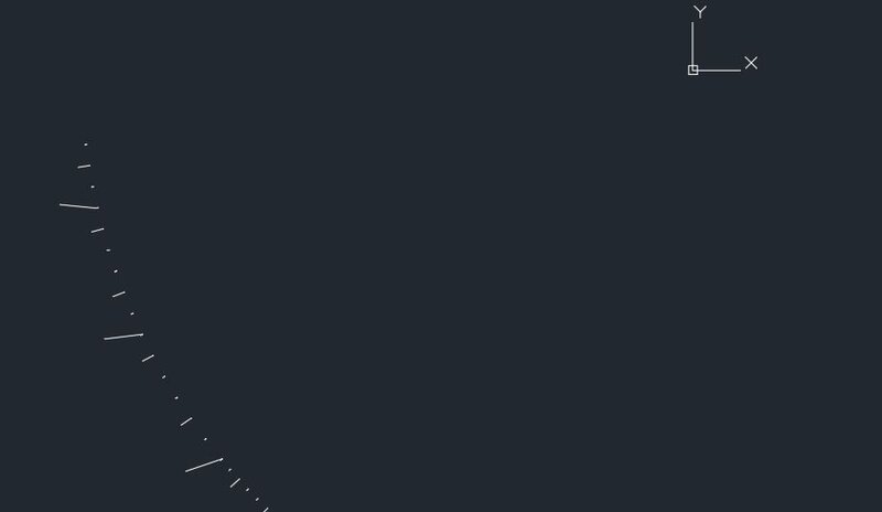

Marcin O Posted May 20, 2025 Posted May 20, 2025 (edited) Dear forum, I have no idea why my lines have sometimes zero length. The azimuth angles in radians are correct. I belive that the size and distances are big enought and far from 0,0,0. still I cant figure out why they are "off". Can somebody tell me why that scripts generates unprecise lines? Thanks in advance (defun round-to-precision (value precision) ; Rounds a value to the specified decimal precision (setq factor (expt 10.0 precision)) (/ (atoi (rtos (* value factor) 2 0)) factor) ) (defun draw-azimuth-line (azimuth length precision) ; Calculate endpoints for the azimuth line ; First point is at distance 5000 from origin (setq end_x (round-to-precision (* 5000.0 (cos azimuth)) precision)) (setq end_y (round-to-precision (* 5000.0 (sin azimuth)) precision)) ; Second point is at distance 5000+length from origin (in same direction) (setq end2_x (round-to-precision (* (+ 5000.0 length) (cos azimuth)) precision)) (setq end2_y (round-to-precision (* (+ 5000.0 length) (sin azimuth)) precision)) ; Draw the line (command "_line" (list end_x end_y 0) (list end2_x end2_y 0) "") ) ; Draw lines based on time intervals (cond ; Main azimuths (every 60 minutes) - 50 unit lines ((= (rem i 60) 0) (draw-azimuth-line azimuth 300.0 2)) ; Quarter-hour azimuths (every 15 minutes) - 25 unit lines ((= (rem i 15) 0) (draw-azimuth-line azimuth 100.0 2)) ; 5-minute azimuths - 15 unit lines ((= (rem i 5) 0) (draw-azimuth-line azimuth 20.0 2)) ) Edited May 20, 2025 by Marcin O remove unnecessary code and attachments Quote

GLAVCVS Posted May 20, 2025 Posted May 20, 2025 Hi The first thing you should check is whether the lines with length 0 have anything to do with OSMODE: disable the object snap and run the command again to check. 2 Quote
Marcin O Posted May 20, 2025 Author Posted May 20, 2025 @CyberAngel Thank You for suggestion, i don't know how. Sometimes it just says line zero-length and x,y same point coordinate which has a precision of 4digits (0.0000). Angles (azimutes) are fine. Quote
Steven P Posted May 20, 2025 Posted May 20, 2025 As Glavcvs suggests, try this: (command "_line" "non" (list end_x end_y 0) "non" (list end2_x end2_y 0) "") where non stops object snaps temporarily. Often a cause for error where it snaps to the wrong thing. My preference is to make entities with the entmake method - objects are placed exactly irrespective of object snaps or grid settings 1 Quote
Marcin O Posted May 20, 2025 Author Posted May 20, 2025 @GLAVCVS@Steven P Thank You for suggestions. You are right , probably that's the issue. I've spent so many hours for try and error. I researched a lot where the issue might be! You've just spot the issue instantly 2 Quote
ronjonp Posted May 20, 2025 Posted May 20, 2025 @Marcin O An example of using entmakex to create the line: ;; Change this (command "_line" (list 10 end_x end_y 0) (list end2_x end2_y 0) "") ;; to this (entmakex (list '(0 . "LINE") (list 10 end_x end_y 0) (list 11 end2_x end2_y 0))) 3 Quote
BIGAL Posted May 20, 2025 Posted May 20, 2025 Like others nearly all code I write has a turn off osnaps or set as required within the code . You can see the numbers for osmode by setting your osnaps then just type osmode. I use 47 a lot. (setq oldsnap (getvar 'osmode)) (setvar 'osmode 0) ... lots of code at end of code (setvar 'osmode oldsnap) want user in code to pick an end point (setvar 'osmode 1) pick center of circle (setvar 'osmode 4) 1 Quote
