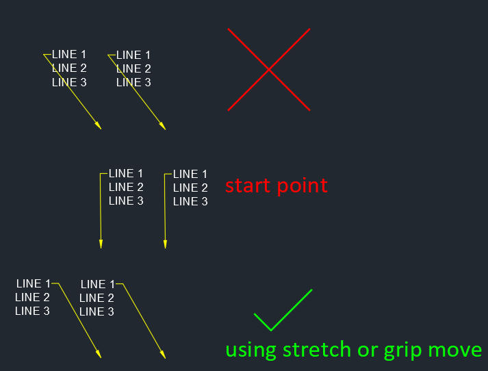

Although it works I end up with a line over strike issue (as show in the image bellow - Top scenario) any ideas how to solve this?
