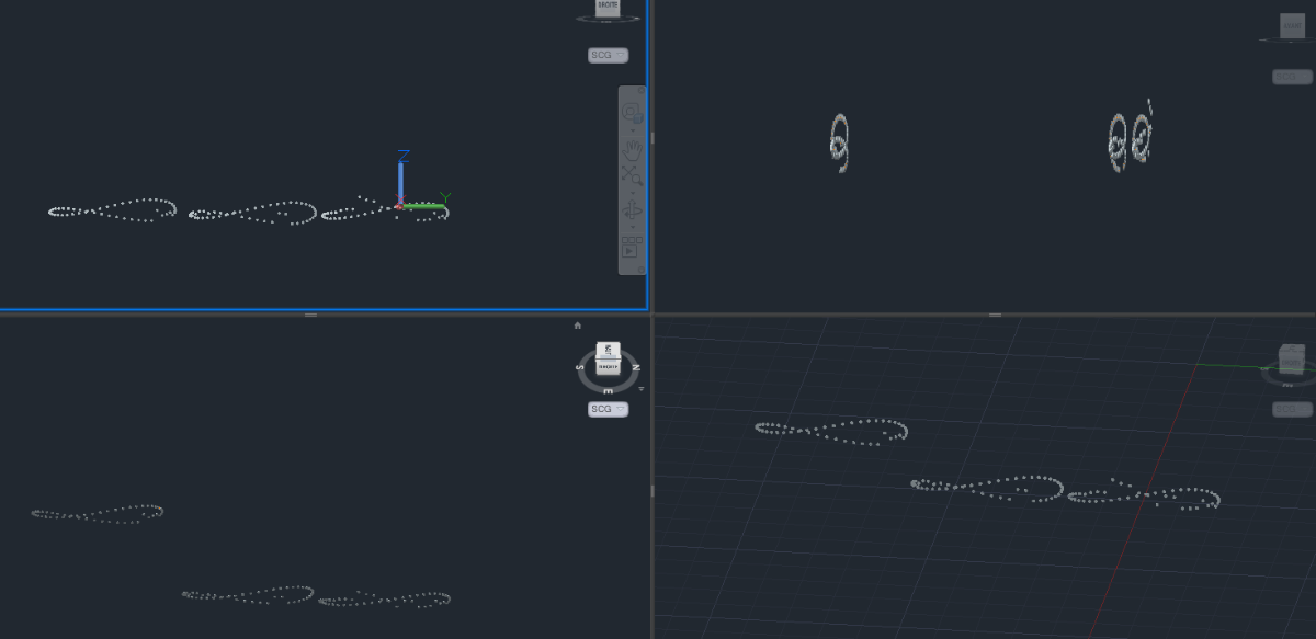

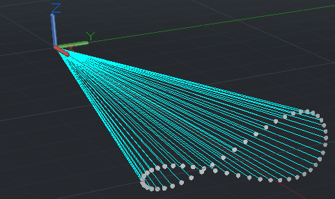

I wrote a script that inserts and rotates 52 occurrences of block "aaa" in a 3d drawing.
_insert aaa 0,0,0 1 1 10.8674180900849 _rotate3d (entlast)  y 0,0,0 1.51506020498407
_insert aaa 0,0,0 1 1 10.3891249598048 _rotate3d (entlast)  y 0,0,0 2.19061147912497
Block aaa is _inserted at origin and rotated 10.867° around z, then re-selected by (entlast) and _rotated 1.515° around y, and so on.
It  works fine:
Then I changed the y rotation axis by defining 2 points. The new axis is parallel to y and crosses x axis:
_insert aaa 0,0,0 1 1 10.8674180900849 _rotate3d (entlast)  50,0,0 50,10,0 1.51506020498407
_insert aaa 0,0,0 1 1 10.3891249598048 _rotate3d (entlast)  50,0,0 50,10,0 2.19061147912497
Problem: the result is not the same depending on what view is selected when I run the script.
Result also changes if the zoom is not the same before running the script.
Below is the result after running the same script in 3 different views (I hid the lines for clarity).
Some blocks are not rotated correctly:
All views use WCS (SCG in french).
What am I doing wrong?

It may even be your osnaps causing problems use Osmode 0, not tested. Snap off also.
Edited by BIGAL
You are the best, it works!
I was far to imagine that a command with absolute coordinates could be disturbed by a graphical object snap mode.
Note: grid snap doesn't cause any problem.
