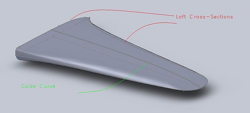

To use boolean operations like union, subtract etc you need to have a solid body. There is a lisp routine calles mesh2solid that will convert your mesh surface to a solid by extruding small triangles down from your mesh and using your surface to cut it. The result will probably not be very attractive though.
Can you post a file or screen shot of what you are working with so we can help you set up your loft cross sections.

here is a wing i drew very quick. I used two cross sections and one guide curve. Then i mirrored the top half. In reality the profile of your bottom wing is difference but just for the picture it was quicker to mirror the whole thing.
This wasnt done in autocad but the procedure is the same. If my cross sections were closed profiles in Acad i would have created a solid.
