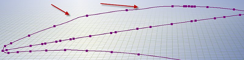

JD Mather Posted April 27, 2009 Posted April 27, 2009 ...project i have for my school! Autodesk Inventor would be far more appropriate for this project. Students can download Inventor for free from http://engineersrule.org I have been given a shape of a wing in 3 dimensions made up with splines Where did the original splines come from? As I suspected way too many uneeded control points on the splines. Quote
kakody1 Posted April 27, 2009 Author Posted April 27, 2009 my school is in greece and we can' t download from this site and besides that we are working with this autocad in school. we are taking exams on this!!! The professor gave us the original splines and i don' t know where they come from! Quote
JD Mather Posted April 27, 2009 Posted April 27, 2009 my school is in greece and we can' t download from this site Any students anywhere in the world can download this free software. we are taking exams on this!!! The professor gave us the original splines and i don' t know where they come from! The original splines are garbage. (see attached) Good luck on the exams. I could recreate the most complex of the original splines with about 6 control points - maybe fewer. It would be far more smooth resulting in a smoother wing surface. Quote
