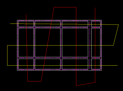

15 minutes ago, Mountain_XD said:
Please help me draw center line by Lisp
For polylines
CPL.lsp
Thank you Nikon. your lisp is good, but i want to draw center lines only once.
Maybe ...
Just an idea you drag over the pairs of lines, you find the correct pairs wont go into that now, then look for shortest and offset it to middle and change layer. So in image draw red pline then yellow pline color just for clarity.
Not sure how your drawing the slab plan may be easier if using a lisp to add the make centerline as part of that code. Yes have draw slabs code.
Edited by BIGAL
