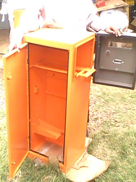

obirimelvin Posted April 22, 2009 Posted April 22, 2009 I'd like assistance with production drawings or working drawing for the item shown in the picture; WHich is the best software to use for this kind of work i.e AutoCAD mechanical,Autocad or Mechanical Desktop Quote
stevsmith Posted April 22, 2009 Posted April 22, 2009 I would tend to use a program with sheetmetal capabilities like inventor or solidworks. I have no experiance with A/M or M/D. You could do it in Autocad, but which would you prefer, 2d or 3d detailing. I fell that Autocad is limited when it comes to sheetmetal works. Even though others may disagree with me. Quote
obirimelvin Posted April 22, 2009 Author Posted April 22, 2009 thanks stevsmith. Never used inventor but I'll sure look into it now Quote
Tankman Posted April 22, 2009 Posted April 22, 2009 Looks easy enough for "vanilla" AutoCAD. Parts drawings and an assembly drawing should do the trick. Worked in the fabrication department of a very big sheetmetal department. All prototype work, loved it. Looks somewhat like a locking gun cabinet. A CNC punch press would be nice! Quote
stevsmith Posted April 22, 2009 Posted April 22, 2009 Just a quick pointer. Im not saying that you can't do it in autocad, but it would be alot simpler and quicker with a parametric program. In my opinion anyway. Quote
obirimelvin Posted April 22, 2009 Author Posted April 22, 2009 Hey Tankman, Can I borrow from your experience, my ultimate goal is fabrication but can't seem to get past this point. Can I get from you a shell *.dwg of the box 36*45*115 - L*W*H @stevsmith Your pointer is acknowledged Quote

Tankman Posted April 23, 2009 Posted April 23, 2009 Hey Tankman,Can I borrow from your experience, my ultimate goal is fabrication but can't seem to get past this point. Can I get from you a shell *.dwg of the box 36*45*115 - L*W*H @stevsmith Your pointer is acknowledged Are you talkin' inches? The image looks much smaller. The material appears to be 12 gauge CRS (cold rolled steel). A simple enough "cabinet" for any sheetmetal worker. CNC punch press for holes 'n corner miters. Timesaver for deburring. Press brake for forming. Spot welding for shelves. Tig or mig welding for corners. Finish, sanding, before painting. At any rate, confirm dimensions and I'll play with it. Bend allowances, blank sizing, depends on the material gauge; i.e.: 12 gauge. 12 gauge is approx 3/32" thick. Is often the gauge used for commercial electrical boxes. 16 gauge is approx 1/16" thick. Quote

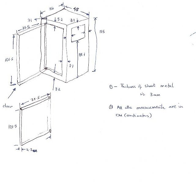

obirimelvin Posted April 23, 2009 Author Posted April 23, 2009 thanks KennyJ and all, I've attached the sketch, and some *.dwg of my attempts. The *.dwg are for 2005 and 2000 autocad Box All.dwg Box All 2000.dwg Quote

Tankman Posted April 23, 2009 Posted April 23, 2009 All looks "well." Too easy a project for a qualified sheet metal fabricator. Would be easy enough to fabricate usin' 12 gauge CRS. Ben allowances would be 1/4" for each 90° bend, (3mm x 2). I find it a bit difficult understanding what you're looking for? Box-Art.dwg Quote
Tankman Posted April 23, 2009 Posted April 23, 2009 Mechanical Desktop has not been sold by Autodesk since Feb 2002. It was discontinued after 2009. I would use Inventor. Inventor will automatically create flat patterns from you as-folded model. Can also do weld beads. Neve used Inventor however, my experience 40+ years in metal fabrication, I can do it all in AutoCad from start to finish; all parts, bottom, top, door, etc. This is too easy a "cabinet" to layout; all 90° bends. Notch the blanks, bend away, spotweld, TIG seams, clean up the welds, paint. Done. Easy enough to fabricate. I guess I just don't get it(?). This is an easy project for a sheet metal fabricator. Quote

obirimelvin Posted April 24, 2009 Author Posted April 24, 2009 Tankman, The challenge I have is making a drawing that will aid the fabrication process; I also want to include more details in the isometric and develop a exploded view of parts.I'm not very experienced with autocad in terms of practice most of my interactions with it was classroom exercise and lots of theory so doing this will help me bridge that gap. Quote
CADguy209 Posted April 27, 2009 Posted April 27, 2009 You can do this all in regular autocad. Not really that hard either. It can all be done 2d or 3d if you want to get fancy. If you are going to make production drawings some of the things you are going to need are: An assembly drawing showing how all the parts fit together. Detail drawings of the individual parts showing the formed, and flat pattern detail of the parts. Indicate the guage of the material on the detail drawings. Knowledge of figuring bend allowances for your given parts/ga material. Quote

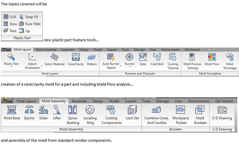

JD Mather Posted April 27, 2009 Posted April 27, 2009 I can do it all in AutoCad from start to finish; all parts, bottom, top, door, etc. Well, I'm quite sure I could do it all in AutoCAD and from art-to-part out on the shop floor as well. I would consider that to be torture though. So much easier in Inventor I would take the $1,300 USD out of my own pocket for Inventor before subjecting myself to the torture. BTW additional information on the plastics - I will be doing a presentation on the new Plastics functionality at 6PM tonight in the Penns' Inn at Penn College. http://www.youtube.com/view_play_list?p=FB61F87E7D0D2DB4 Quote
