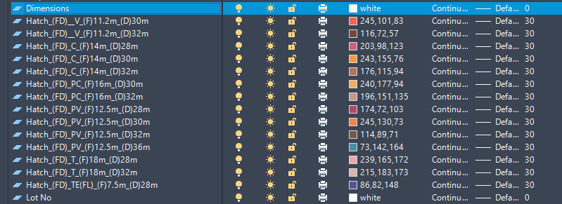

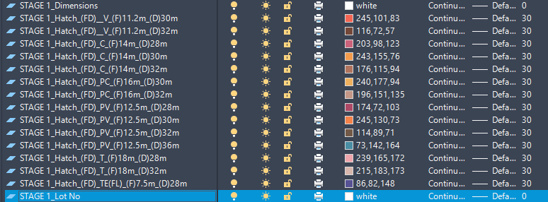

andyb57J Posted June 9, 2025 Posted June 9, 2025 I currently use the attached lisp to add a suffix (generally Staging layer numbers) or prefix to selected layers within a drawing so that each item within a stage is on its own layer so that they can be set to not visible with plans not within a set stage. This works fine where developments have a minimum number of stages but I was wondering if someone could modify it so that the user can set the number of stages and the lisp will then create all the necessary layers in one go. The initial layers are generally shown as With the updated layers having the identifying Stage no as a prefix. Is it possible to update the lisp so that the user can set the number of Stages (ie 1 - 32) and the lisp to then create all the stage layers at one time. I have included a dwg file which may assist. (defun C:CNL ( / acdoc cnt el la llst lt lw lyrs np nl pr ss su tr) (vl-load-com) (setq AcDoc (vla-get-ActiveDocument (vlax-get-acad-object)) lyrs (vla-get-layers acdoc) ) (vla-StartUndoMark AcDoc) (if (and (setq ss (ssget ":L")) (setq pr (getstring T "\nEnter Prefix for new layers from selected objects <ENTER for None>: ")) (setq su (getstring T "\nEnter suffix for new layers from selected objects <ENTER for None>: ")) (not (= pr su "")) ) (progn (repeat (setq cnt (sslength ss)) (setq el (entget (ssname ss (setq cnt (1- cnt)))) la (cdr (assoc 8 el)) ) (if (not (member la llst))(setq llst (cons la llst))) ) (setq cnt 0) (foreach n llst (if (not (tblsearch "LAYER" (strcat pr n su))) (progn (setq ob (vlax-ename->vla-object (setq el (tblobjname "LAYER" n))) col (vla-get-truecolor ob) lt (vla-get-linetype ob) lw (vla-get-lineweight ob) np (vla-get-plottable ob) nl (vla-add lyrs (strcat pr (vla-get-name ob) su)) tr (getpropertyvalue el "Transparency") ) (vla-put-truecolor nl col) (vla-put-linetype nl lt) (vla-put-lineweight nl lw) (vla-put-plottable nl np) (setpropertyvalue (vlax-vla-object->ename nl) "Transparency" tr) (if (tblsearch "LAYER" (strcat pr n su))(setq cnt (1+ cnt))) ) ) ) (if (> cnt 0)(princ (strcat "\n(" (itoa cnt) ") New Layers Created."))) ) (if (= pr su "")(princ "\nNo Suffix or Prefix Given - No new layers created.")) ) (vla-EndUndoMark AcDoc) (princ) ) (princ) CNL.lsp Test.dwg Quote

pkenewell Posted June 9, 2025 Posted June 9, 2025 (edited) 1 hour ago, andyb57J said: Thankyou for the effort but I don't think I explained myself well enough. What I was hoping for was that if I required, for example, 32 stages that the lisp would create all the layers selected by adding the prefix Stage 1 through to Stage 32 so in effect creating over 500 odd layers. Each selected layer would have the prefix. Perhaps the user could input a start no (i.e 1) and the last stage no. (i.e 32) and the lisp would automatically add the prefix from 1 to 32 to all the selected layers. @andyb57J Ok I understand. Questions: 1) is the prefix separate; to still be prompted for, or is just "STAGE" always the prefix? Or both? 2) Still prompt for Suffix? 3) Do you always want a SPACE between the "STAGE" and the number? Edited June 9, 2025 by pkenewell Quote

ronjonp Posted June 9, 2025 Posted June 9, 2025 (edited) @andyb57J Here's another way to do it using entmakex. I hardcoded the 'STAGE' prefix: (defun c:cnl (/ cnt el i la llst ss) (if (and (setq ss (ssget)) (> (setq i (getint "\nEnter number of stages: ")) 0)) (progn (repeat (setq cnt (sslength ss)) (setq el (entget (ssname ss (setq cnt (1- cnt)))) la (cdr (assoc 8 el)) ) (or (member la llst) (setq llst (cons la llst))) ) (foreach n llst (setq cnt 0) (repeat i (setq el (entget (tblobjname "LAYER" n) '("*"))) (entmakex (subst (cons 2 (strcat "STAGE " (itoa (setq cnt (1+ cnt))) "_" n)) (assoc 2 el) el) ) ) ) ) ) (princ) ) Edited June 12, 2025 by ronjonp 1 1 Quote
andyb57J Posted June 10, 2025 Author Posted June 10, 2025 1 hour ago, ronjonp said: @andyb57J Here's another way to do it using entmakex. I hardcoded the 'STAGE' prefix: (defun c:cnl (/ cnt el i la llst ss) (if (and (setq ss (ssget)) (> (setq i (getint "\nEnter number of stages: ")) 0)) (progn (repeat (setq cnt (sslength ss)) (setq el (entget (ssname ss (setq cnt (1- cnt)))) la (cdr (assoc 8 el)) ) (or (member la llst) (setq llst (cons la llst))) ) (foreach n llst (setq cnt 0) (repeat i (setq el (entget (tblobjname "LAYER" n) '("*"))) (entmakex (subst (cons 2 (strcat "STAGE " (itoa (setq cnt (1+ cnt))) "_" n)) (assoc 2 el) el) ) ) ) ) ) (princ) ) (princ) Thankyou. Exactly what I needed Quote
