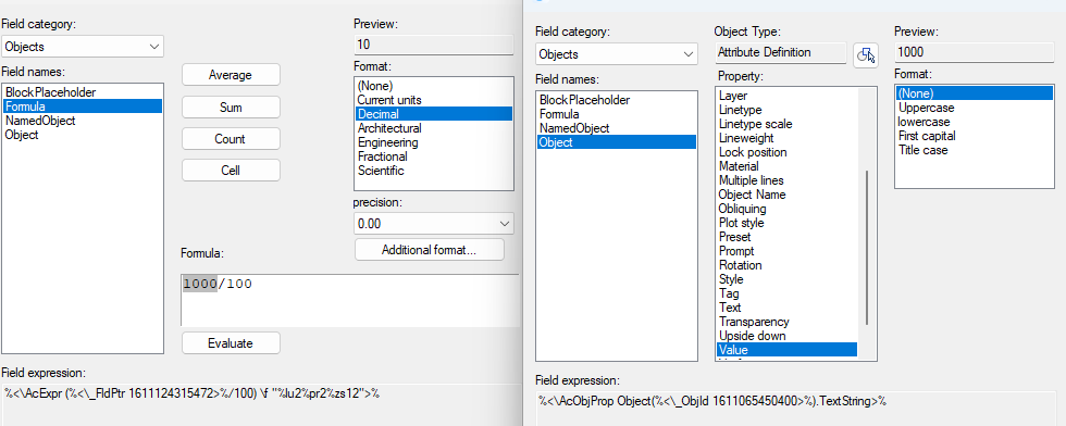

wing Posted June 13, 2025 Posted June 13, 2025 Just trying to get my field formula based on attribute definition to work. It does not update. My steps below: New drawing. I create attdef (default value: 1000) I create a text. I add field (ctrl F) in that text. In the field dialog box, Objects>Formula Right click in formula, insert field (a nested field). Object>Select the attribute definition. In the formula box, I add "/100". 1000 divide by 100 equals 10. 10 is what I want based on default 1000 value. Save dwg. New dwg, insert block, select that dwg. But when I change the attdef value. It does not refresh. Eg. Attribute change to 200, the field should change to 2. Help please. Thanks. Quote

wing Posted June 19, 2025 Author Posted June 19, 2025 (edited) Insert the attached test block into drawing. Default value of block attribute is 1000. If you change that block attribute, the changed attribute values doesn't seem to get passed through. It still stuck on default value. I tried regen, switching from model, to paper and then back to model space. It doesn't work. testblock.dwg Edited June 19, 2025 by wing Quote
wing Posted June 19, 2025 Author Posted June 19, 2025 Hello, I found this info. Seems like the block id gets changed every instance but the reference within the formula doesn't update accordingly, so REGEN doesn't work. User variables was the suggested solution. https://www.autodesk.com/support/technical/article/caas/sfdcarticles/sfdcarticles/Field-calculations-within-AutoCAD-blocks.html Quote
BIGAL Posted June 19, 2025 Posted June 19, 2025 You are correct for every attribute it has only one single ID, so when you insert the block again you get ID 2. One way around it is to use a lisp to insert the block and add the correct ID to the text. Now where did I put it. Quote
