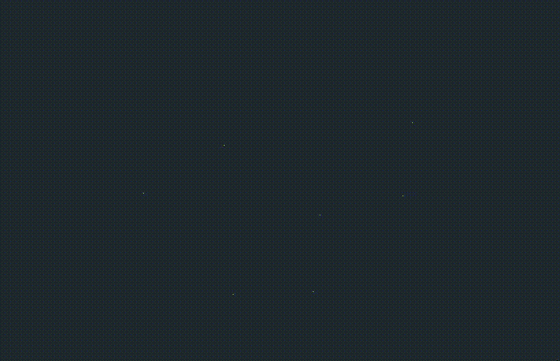

DATVO Posted 16 hours ago Posted 16 hours ago (edited) Here's the code. I hope this helps you. The MLeader style follows your current style. Looking for tools to speed up your workflow? Explore this resource: https://lispautocad.gumroad.com/l/eezilo (defun C:DV_MLP (/ pt x y text) (vl-load-com) (setvar "CMDECHO" 0) (setq pt (getpoint "\nPick point: ")) (if pt (progn (setq x (rtos (car pt) 2 3)) (setq y (rtos (cadr pt) 2 3)) (setq text (strcat "(" x " ; " y ")")) (command "._MLEADER" pt pause text) ) (princ "\nNo Point selected!") ) (setvar "CMDECHO" 1) (princ) ) Edited 16 hours ago by DATVO 1 Quote
