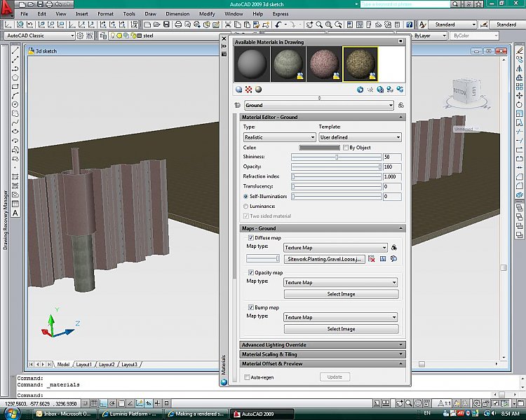

I'm drawing a sheet pile wall on a lake bed. But the image i loaded in for the lake bed you can't really tell what the material is. I want to make the stone base I have appear larger. If anyone knows how to do this let me know. I'm sure it's something simply and I'll laugh once I find out

you mean you want to change the scale of the image(material) in relation to the part? In your materials window next to the file name of your diffuse map or bump map there is a little button that will allow you to edit the map. you can change the scale, tile size, stretch it etc. I cant get you a screen shot until tonight because i dont have 09 in front of me.
I've got a screen shot of the material menu. Could you please let me know which icon it is that you are talking about.
Thanks
You can change the material size from"material scaling & tiling"!
P.s...you must use "material mapping" to your model to see right scale of
material image!:):)
just as papagyi said. the material scaling & tiling tab.
