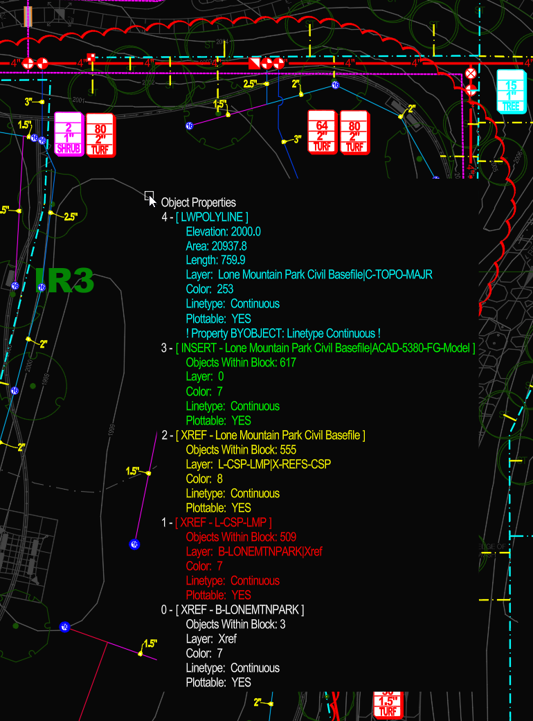

Danielm103 Posted yesterday at 02:38 AM Posted yesterday at 02:38 AM (edited) Not lisp, One approach would be to use a point monitor https://www.cadtutor.net/forum/topic/98349-use-a-point-monitor-to-add-items-to-the-hover-tooltip/ A draw jig might be also work depending on the context. Edited yesterday at 02:39 AM by Danielm103 2 Quote
