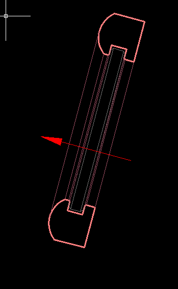

Is there a stretch at an angle  or along path?
Edit: I found the UCS rotation..
UCS
Z 165
With this  I can draw lines at custom angles.
However, the Stretch command does still have selection box going straight up and down (following world UCS)
Is there a way to have the selection box aligned with UCS as well?
Edited by Discus84
The only reliable way I know to align the stretch box is to turn the model by changing the UCS. Use the PLAN command to redraw the model in the current UCS. There's probably a way to do that without a Zoom Extents in the bargain (Dview Twist?). When you're through, change the UCS back to World and run PLAN again.
A bit of research says Dview may turn the camera without changing the UCS. Even better. You can change back to the normal view when you finish your stretch, no UCS change or PLAN necessary.
