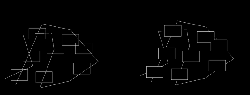

Mountain_XD Posted June 26, 2025 Posted June 26, 2025 Please help me Trim Lines inside Rectangs. Thank you so much Trim Lines inside Rectangs.dwg Quote
SLW210 Posted June 26, 2025 Posted June 26, 2025 Sorry it took me a while to clean this up, it worked on your sample drawing. I was trying to get it to do any closed shape, but couldn't get Ellipses and Pline Ellipses to work. I'll get back to that when time allows. ;;; Trim (Lines & LWPolylines) Inside Closed Shapes (LWPolylines & Circles) = TICS | ;;; | ;;; https://www.cadtutor.net/forum/topic/98452-trim-lines-inside-rectangs/#findComment-674554 | ;;; | ;;; By SLW210 (a.k.a. Steve Wilson) | ;;; | ;;; TICS.lsp | ;;; | ;;; (Needs improvement, need to add Ellipses and Pline Ellipses to Shapes to trim with.) | ;;; | ;;;================================================================================================| (defun evenp (n) (= (rem n 2) 0)) (defun ent-in-ss (ent ss / i found) (setq found nil i 0 ) (while (and (< i (sslength ss)) (not found)) (if (equal ent (ssname ss i)) (setq found T) (setq i (1+ i)) ) ) found ) ;; Ray casting algorithm for closed LWPolyline. (defun point-inside-polygon (pt plObj / crossings i paramCount p1 p2) (setq crossings 0) (setq pCount (fix (vlax-curve-getEndParam plObj))) (setq i 0) (while (< i pCount) (setq p1 (vlax-curve-getPointAtParam plObj i)) (setq p2 (vlax-curve-getPointAtParam plObj (1+ i))) (if (and (> (cadr pt) (min (cadr p1) (cadr p2))) (<= (cadr pt) (max (cadr p1) (cadr p2))) (< (car pt) (+ (car p1) (* (- (cadr pt) (cadr p1)) (/ (- (car p2) (car p1)) (- (cadr p2) (cadr p1))) ) ) ) ) (setq crossings (1+ crossings)) ) (setq i (1+ i)) ) (not (evenp crossings)) ) ;;;================================================================================================| (defun c:TICS (/ ssShapes ssLines i j ent entObj shapeEnt shapeObj shapeType pts allIntPts p1 p2 mid inside? origColor ) (vl-load-com) (prompt "\n--- Trim Lines & LWPolylines Inside Circles & Closed LWPoplylines ---\n" ) ;; Prompt to select shapes for trimming (prompt "\nSelect closed polylines or circles as trimming boundaries:" ) (setq ssShapes (ssget '((0 . "LWPOLYLINE,CIRCLE")))) (if (not ssShapes) (progn (prompt "\nNo valid trimming shapes selected.") (exit)) ) ;; Select all lines and polylines in drawing (setq ssLines (ssget "X" '((0 . "LINE,LWPOLYLINE")))) (if (not ssLines) (progn (prompt "\nNo lines or polylines found to trim.") (exit)) ) (setq i 0) (while (< i (sslength ssLines)) (setq ent (ssname ssLines i)) (if (not (ent-in-ss ent ssShapes)) (progn (setq entObj (vlax-ename->vla-object ent)) (setq origColor (vla-get-Color entObj)) ;; Collect intersection points with all shapes (setq allIntPts '()) (setq j 0) (while (< j (sslength ssShapes)) (setq shapeEnt (ssname ssShapes j)) (setq shapeObj (vlax-ename->vla-object shapeEnt)) (setq shapeType (cdr (assoc 0 (entget shapeEnt)))) (if (or (= shapeType "LWPOLYLINE") (= shapeType "CIRCLE")) (progn (setq pts (vlax-invoke shapeObj 'IntersectWith entObj acExtendNone ) ) (if (and pts (> (length pts) 2)) (progn (repeat (/ (length pts) 3) (setq allIntPts (append allIntPts (list (list (car pts) (cadr pts) (caddr pts) ) ) ) ) (setq pts (cdddr pts)) ) ) ) ) ) (setq j (1+ j)) ) (if (null allIntPts) (progn (setq mid (cond ((= (vla-get-objectname entObj) "AcDbLine") (mapcar '(lambda (a b) (/ (+ a b) 2.0)) (vlax-get entObj 'StartPoint) (vlax-get entObj 'EndPoint) ) ) ((= (vla-get-objectname entObj) "AcDbPolyline") (vlax-curve-getPointAtDist entObj (/ (vlax-curve-getDistAtParam entObj (vlax-curve-getEndParam entObj) ) 2.0 ) ) ) (T nil) ) ) (setq inside? nil) (setq j 0) (while (and (< j (sslength ssShapes)) (not inside?)) (setq shapeEnt (ssname ssShapes j)) (setq shapeObj (vlax-ename->vla-object shapeEnt)) (setq shapeType (cdr (assoc 0 (entget shapeEnt)))) (setq inside? (cond ((= shapeType "LWPOLYLINE") (point-inside-polygon mid shapeObj) ) ((= shapeType "CIRCLE") (< (distance mid (vlax-get shapeObj 'Center)) (vlax-get shapeObj 'Radius) ) ) (T nil) ) ) (setq j (1+ j)) ) (if inside? (entdel ent) ) ) (progn (setq allIntPts (append (list (vlax-curve-getStartPoint ent)) allIntPts (list (vlax-curve-getEndPoint ent)) ) ) (setq allIntPts (vl-sort allIntPts (function (lambda (a b) (< (vlax-curve-getDistAtPoint ent a) (vlax-curve-getDistAtPoint ent b) ) ) ) ) ) (entdel ent) (setq j 0) (while (< j (1- (length allIntPts))) (setq p1 (nth j allIntPts)) (setq p2 (nth (1+ j) allIntPts)) (setq mid (mapcar '(lambda (a b) (/ (+ a b) 2.0)) p1 p2)) (setq inside? nil) (setq k 0) (while (and (< k (sslength ssShapes)) (not inside?)) (setq shapeEnt (ssname ssShapes k)) (setq shapeObj (vlax-ename->vla-object shapeEnt)) (setq shapeType (cdr (assoc 0 (entget shapeEnt)))) (setq inside? (cond ((= shapeType "LWPOLYLINE") (point-inside-polygon mid shapeObj) ) ((= shapeType "CIRCLE") (< (distance mid (vlax-get shapeObj 'Center) ) (vlax-get shapeObj 'Radius) ) ) (T nil) ) ) (setq k (1+ k)) ) (if (not inside?) (entmakex (list '(0 . "LINE") (cons 10 p1) (cons 11 p2) (cons 62 origColor) ) ) ) (setq j (1+ j)) ) ) ) ) ) (setq i (1+ i)) ) (prompt "\nDone trimming inside shapes.") (princ) ) (princ "\nType 'TICS' to run the command.") 1 Quote
SLW210 Posted June 26, 2025 Posted June 26, 2025 P.S. If you do need to do Ellipses there are some LISPs around to convert an Ellipse to a Pline and for Polyline Ellipse (2D Polyline) you can explode> Pedit>M (Multiple)>Join and this LISP will work. That's what I did, it works pretty fast converting the Ellipses, probably why I didn't keep working on the complete LISP. Quote
BIGAL Posted June 27, 2025 Posted June 27, 2025 (edited) Another give this a try, forgot yesterday to click on post, code was still there. Must be plines, checks for pline direction. may want to change the 20 dist val. ; https://www.cadtutor.net/forum/topic/98452-trim-lines-inside-rectangs/ (defun c:triminsiderect ( / oldsnap ss plent obj area1 area2 dist co-ord) (setq oldsnap (getvar 'osmode)) (setvar 'osmode 0) (princ "\n\Select closed plines \n") (setq ss (ssget (list (cons 0 "LWPOLYLINE")(cons 70 1)))) (If ss (repeat (setq x (sslength ss)) (setq plent (ssname ss (setq x ( 1- x)))) (setq obj (vlax-ename->vla-object plent)) (setq dist 20.0) (setq area1 (vlax-get obj 'Area)) (vla-offset obj dist) (setq objnew (vlax-ename->vla-object (entlast))) (setq area2 (vlax-get objnew 'Area)) (if (> area1 area2) (progn (setq co-ord (mapcar 'cdr (vl-remove-if-not '(lambda (x) (= (car x) 10)) (entget (entlast))))) (vla-delete (vlax-ename->vla-object (entlast))) ) (progn (vla-offset obj (- dist)) (setq co-ord (mapcar 'cdr (vl-remove-if-not '(lambda (x) (= (car x) 10)) (entget (entlast))))) (vla-delete (vlax-ename->vla-object (entlast))) ) ) (setq co-ord (cons (last co-ord) co-ord)) (command "trim" plent "" "F" co-ord "" "") ) ) (setvar 'osmode oldsnap) (princ) ) (c:trinsiderect) Edited June 30, 2025 by BIGAL Quote
SLW210 Posted June 30, 2025 Posted June 30, 2025 On 6/26/2025 at 10:46 PM, BIGAL said: Another give this a try, forgot yesterday to click on post, code was still there. Must be plines, checks for pline direction. may want to change the 20 dist val. ; https://www.cadtutor.net/forum/topic/98452-trim-lines-inside-rectangs/ (defun c:trinsiderect ( / oldsnap ss plent obj area1 area2 dist co-ord) (setq oldsnap (getvar 'osmode)) (setvar 'osmode 0) (princ "\n\Select closed plines \n") (setq ss (ssget (list (cons 0 "LWPOLYLINE")(cons 70 1)))) (If ss (repeat (setq x (sslength ss)) (setq plent (ssname ss (setq x ( 1- x)))) (setq obj (vlax-ename->vla-object plent)) (setq dist 20.0) (setq area1 (vlax-get obj 'Area)) (vla-offset obj dist) (setq objnew (vlax-ename->vla-object (entlast))) (setq area2 (vlax-get objnew 'Area)) (if (> area1 area2) (progn (setq co-ord (mapcar 'cdr (vl-remove-if-not '(lambda (x) (= (car x) 10)) (entget (entlast))))) (vla-delete (vlax-ename->vla-object (entlast))) ) (progn (vla-offset obj (- dist)) (setq co-ord (mapcar 'cdr (vl-remove-if-not '(lambda (x) (= (car x) 10)) (entget (entlast))))) (vla-delete (vlax-ename->vla-object (entlast))) ) ) (setq co-ord (cons (last co-ord) co-ord)) (command "trim" plent "" "F" co-ord "" "") ) ) (setvar 'osmode oldsnap) (princ) ) (c:trinsiderect) I get an error with this after selecting closed polylines. TrInsideRect.lsp successfully loaded. Command: Command: Command: trinsiderect Select closed plines Select objects: Specify opposite corner: 15 found 3 were filtered out. Select objects: ; error: Automation Error. Description was not provided. Quote
BIGAL Posted June 30, 2025 Posted June 30, 2025 Not sure why it did not work for you, maybe remove the (cons 70 1). You can email me your test dwg. Note what it did for the overlapping rectangs. Quote
SLW210 Posted July 1, 2025 Posted July 1, 2025 I'll look into it. My test drawing was practically the same as yours. Quote
Mountain_XD Posted July 8, 2025 Author Posted July 8, 2025 Thank you so much SLW210. Your code very good (defun c:TICS) Quote
