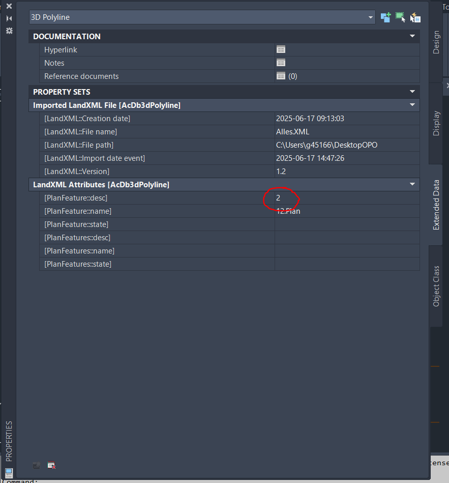

I'm using Autodesk Civil 3D Version 2024 and looking for a solution of following issue. I imported polylines from a LandXML file, and want to distribute them automatically to different layer according to the different codes that are imported as LandXMLAttributes (AcDb3dPolyline) PlanFeature::desc. For example if the the PlanFeature::desc of a polyline is 2 it should be moved to the layer "0_BOK". Does one of you have a solution for this issue?

Attached the file and also a picture of the extended attributes, I would like to use for the routine. Once there is a solution I want to have a kind of codelist for all lines.
This is as far as I got, I am sure could find other values by digging more.
