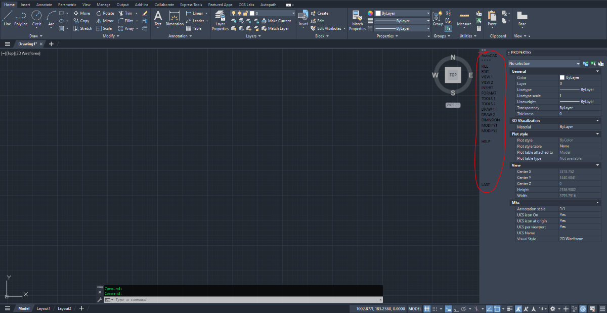

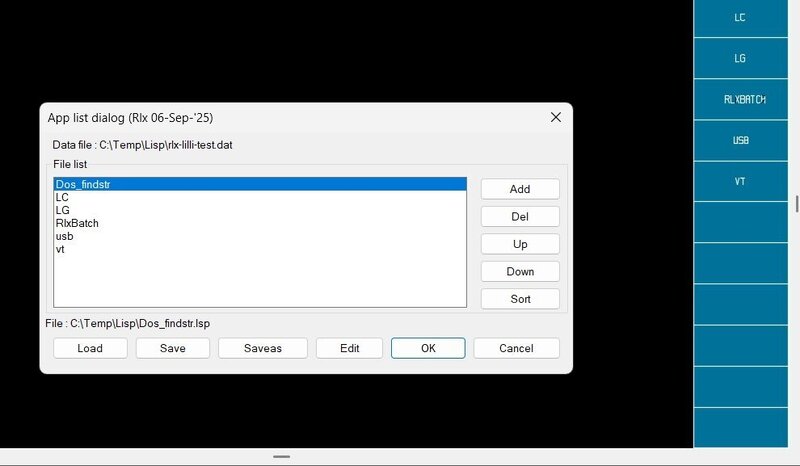

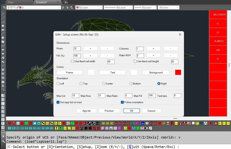

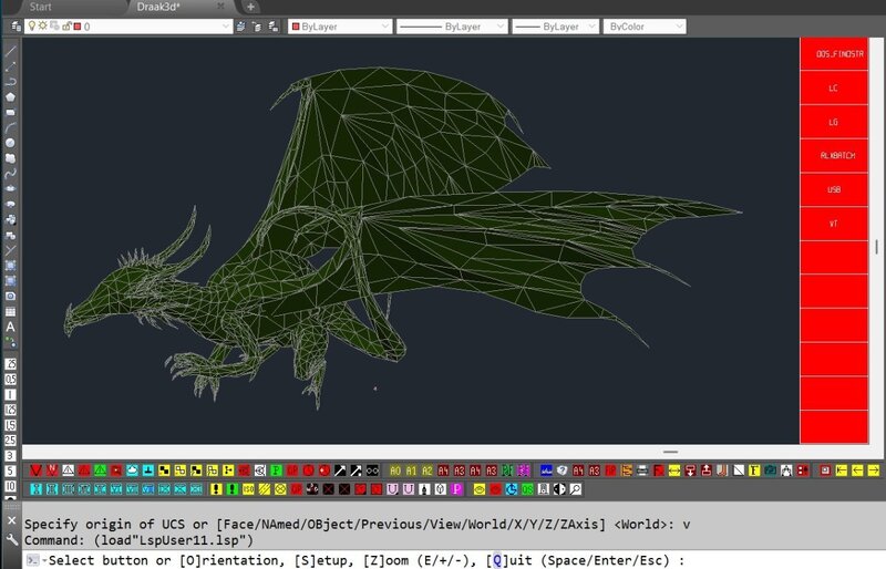

I wanted more buttons but ran out of space so just created an alternative reallity for myself.
It's very basic / simple and still a work in progress but as usual time is not on my side especially now my boss in away for 4 weeks and he probably was afraid I would get bored and start to play with myself so he left me with a 💩 load of work.
Update :  because this routine uses grread you can't run any other (transparent) commands.
Thats why I added 'hot' keys for zoom. E for extents, Z for zoom , + & - for zooming in & out.
Maybe it's useful , maybe it's not...bite me.
;;; RlxGrMenu - 2025-07-09 - Just a funny / very basic little 'toolbar'
;;; It draws a column with 12 rows. Config is not working yet, quit by click or by typing Q or q.
;;; I've run a little out of button-space so wanted an out of the box solution to this problem.
;;; this is just a way to run my 10 most used lisp routines, nothing more , nothing less.
;;; Substitute the names in app-list (setq app-list '("LC" "VT" ...) with names from your own favorite apps
;;; apps have to be in search path so (findfile (strcat "MyApp" ".lsp") should work'.
;;; Also app should not be self executing and the start command should be same as app name
;;; If your app is named "MyApp" this routine loads app if found and starts it with (eval (read (strcat "C:" "Myapp")))
;;; have fun

did a little cleaning & tweaking and added a (grdraw) background to give it just a tiny bit more spunk ... enjoy

13 hours ago, rlx said:
This reminds me on SCREENMENU (picture 1), but you're solution are better 👍. One old programmer with a lot experience in programming, in AutoCAD, told me about SCREENMENU when I tried to do something. And I forget to mention, I have never done anything with SCREENMENU 😅.
