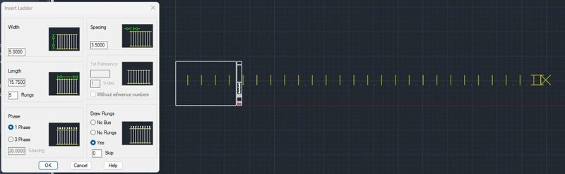

bustr Posted July 17, 2025 Posted July 17, 2025 Autodesk seems to go out of their way to match the difficulty of intools, lotus notes and IFP-PRO. Can anyone tell me why my ladder is horizontal (There was no option in the dialog box for orientation.), why it has more rungs than specified, why there are no busses and why there is an "X" at the end. Autodesk's forums are useless so I don't expect to get an answer from them. Quote
SLW210 Posted July 18, 2025 Posted July 18, 2025 What version of AutoCAD Electrical? Unless it's changed, you go to Drawing Properties under the Drawing Format tab and select "Vertical" under Ladder Defaults. Maybe this will help... AutoCAD Electrical 2025 Help | To Work With Ladders | Autodesk Quote
