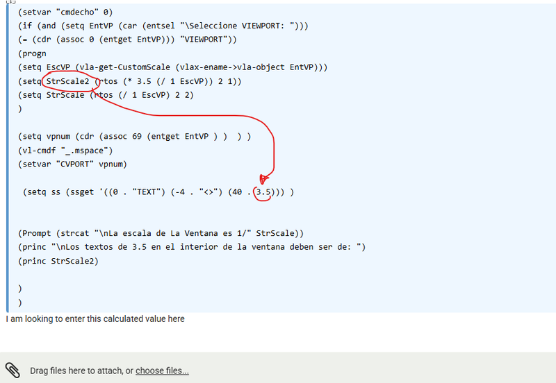

leonucadomi Posted 2 hours ago Posted 2 hours ago hello guys: I need a selection filter to select texts and mtext other than 3.5 in size try this code from Master Lee (ssget '((0 . "CIRCLE") (-4 . "<>") (40 . 5.0))) modified (defun c:pru (/ ss ) (ssget '((0 . "TEXT") (-4 . "<>") (40 . 3.5))) (princ) ) I need to identify texts other than 3.5 with some color. help please thanks Quote
