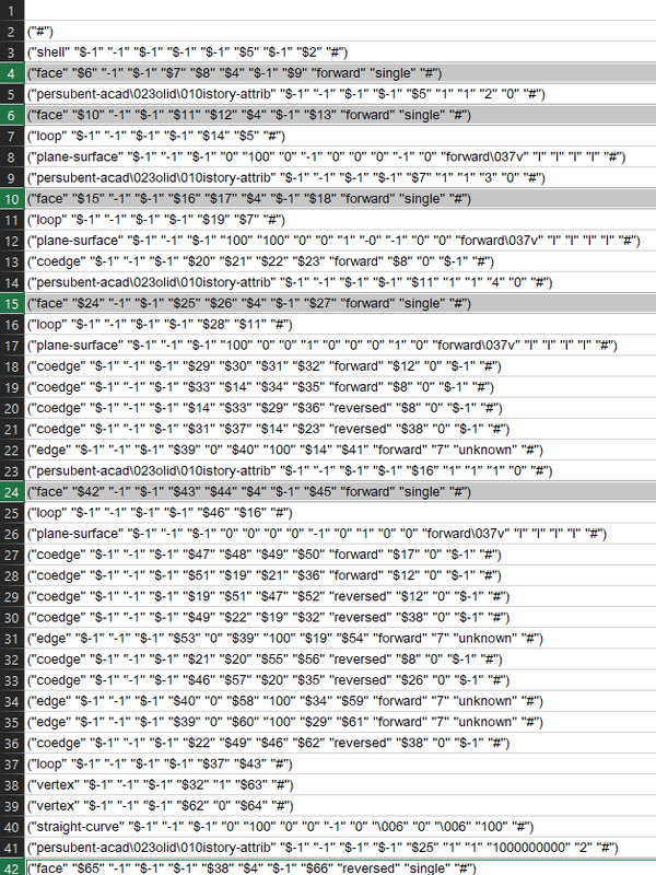

dexus Posted August 11 Posted August 11 Hello everyone, I'm trying to extract points/vertices from a 3D solid. The first way I tried was by exploding it into lines and arcs and then collecting the points. This works, but it is very slow. After that I found ACISdecode function by Kailas Dhage and used it to get some information about the 3D Solid. On a lot of 3D Solid it works and extracts the points correctly. But sometimes if I move the object, the point's inside of the ACIS data don't move. I'm trying to find where the transformation is stored so I can apply it to the exported points as well, but can't seem to find it. Code to export the points below, and an example drawing attached on which it doesn't work correctly. Hope someone can guide me in the right direction! (defun c:solid->pts ( / ent enx i rtn _acis) (defun _acis (enx / itm lin dxf str cha rtn) ; ACISdecode by Kailas Dhage (kailas@uts.com) ; Newsgroups: autodesk.autocad.customization 1999/05/10 ; Modified to work directly on entget data by dexus 2025/08/11 (while (setq dxf (assoc 1 enx)) (setq str (reverse (vl-string->list (cdr dxf))) itm nil lin nil) (while str (setq cha (car str) str (cdr str)) (cond ((= cha 95)) ((= cha 86) (setq itm (cons 73 itm))) ((= cha 32) (setq lin (cons (if itm (vl-list->string itm) "") lin) itm nil)) ((boole 6 cha 95) (setq itm (cons (boole 6 cha 95) itm))) ) ) (setq rtn (cons (cons (if itm (vl-list->string itm) "") lin) rtn) enx (cdr (member dxf enx))) ) (reverse rtn) ) (if (and (setq ent (car (entsel))) (setq enx (entget ent)) ) (foreach i (_acis enx) ; Princ result of the ACIS decode (princ "\n") (princ (vl-prin1-to-string i)) (if (and (equal (car i) "point") (> (length i) 5) (setq i (cddddr i))) (entmakex (list '(0 . "POINT") (cons 10 (list (distof (car i)) (distof (cadr i)) (distof (caddr i)) ) ) ) ) ) ) ) (princ) ) points.dwg Quote
dexus Posted August 12 Author Posted August 12 Below is the output I get from the routine, but I cant find where the transform is made... ("21800" "93" "2" "12" "" "" "" "" "" "" "" "" "" "") ("16" "\001utodesk" "\001uto\003\001\004" "19" "\001\023\r" "220.0.0.5400" "\016\024" "0" "" "") ("25.399999999999999" "9.9999999999999995e-007" "1e-010" "") ("asmheader" "$-1" "-1" "12" "220.0.0.5400" "#") ("body" "$-1" "-1" "$-1" "$2" "$-1" "$3" "#") ("lump" "$-1" "-1" "$-1" "$-1" "$4" "$1" "#") ("#") ("shell" "$-1" "-1" "$-1" "$-1" "$-1" "$5" "$-1" "$2" "#") ("face" "$6" "-1" "$-1" "$7" "$8" "$4" "$-1" "$9" "forward" "single" "#") ("persubent-acad\023olid\010istory-attrib" "$-1" "-1" "$-1" "$-1" "$5" "1" "1" "2" "0" "#") ("face" "$10" "-1" "$-1" "$11" "$12" "$4" "$-1" "$13" "forward" "single" "#") ("loop" "$-1" "-1" "$-1" "$-1" "$14" "$5" "#") ("plane-surface" "$-1" "-1" "$-1" "0" "100" "0" "-1" "0" "0" "0" "-1" "0" "forward\037v" "I" "I" "I" "I" "#") ("persubent-acad\023olid\010istory-attrib" "$-1" "-1" "$-1" "$-1" "$7" "1" "1" "3" "0" "#") ("face" "$15" "-1" "$-1" "$16" "$17" "$4" "$-1" "$18" "forward" "single" "#") ("loop" "$-1" "-1" "$-1" "$-1" "$19" "$7" "#") ("plane-surface" "$-1" "-1" "$-1" "100" "100" "0" "0" "1" "-0" "-1" "0" "0" "forward\037v" "I" "I" "I" "I" "#") ("coedge" "$-1" "-1" "$-1" "$20" "$21" "$22" "$23" "forward" "$8" "0" "$-1" "#") ("persubent-acad\023olid\010istory-attrib" "$-1" "-1" "$-1" "$-1" "$11" "1" "1" "4" "0" "#") ("face" "$24" "-1" "$-1" "$25" "$26" "$4" "$-1" "$27" "forward" "single" "#") ("loop" "$-1" "-1" "$-1" "$-1" "$28" "$11" "#") ("plane-surface" "$-1" "-1" "$-1" "100" "0" "0" "1" "0" "0" "0" "1" "0" "forward\037v" "I" "I" "I" "I" "#") ("coedge" "$-1" "-1" "$-1" "$29" "$30" "$31" "$32" "forward" "$12" "0" "$-1" "#") ("coedge" "$-1" "-1" "$-1" "$33" "$14" "$34" "$35" "forward" "$8" "0" "$-1" "#") ("coedge" "$-1" "-1" "$-1" "$14" "$33" "$29" "$36" "reversed" "$8" "0" "$-1" "#") ("coedge" "$-1" "-1" "$-1" "$31" "$37" "$14" "$23" "reversed" "$38" "0" "$-1" "#") ("edge" "$-1" "-1" "$-1" "$39" "0" "$40" "100" "$14" "$41" "forward" "7" "unknown" "#") ("persubent-acad\023olid\010istory-attrib" "$-1" "-1" "$-1" "$-1" "$16" "1" "1" "1" "0" "#") ("face" "$42" "-1" "$-1" "$43" "$44" "$4" "$-1" "$45" "forward" "single" "#") ("loop" "$-1" "-1" "$-1" "$-1" "$46" "$16" "#") ("plane-surface" "$-1" "-1" "$-1" "0" "0" "0" "0" "-1" "0" "1" "0" "0" "forward\037v" "I" "I" "I" "I" "#") ("coedge" "$-1" "-1" "$-1" "$47" "$48" "$49" "$50" "forward" "$17" "0" "$-1" "#") ("coedge" "$-1" "-1" "$-1" "$51" "$19" "$21" "$36" "forward" "$12" "0" "$-1" "#") ("coedge" "$-1" "-1" "$-1" "$19" "$51" "$47" "$52" "reversed" "$12" "0" "$-1" "#") ("coedge" "$-1" "-1" "$-1" "$49" "$22" "$19" "$32" "reversed" "$38" "0" "$-1" "#") ("edge" "$-1" "-1" "$-1" "$53" "0" "$39" "100" "$19" "$54" "forward" "7" "unknown" "#") ("coedge" "$-1" "-1" "$-1" "$21" "$20" "$55" "$56" "reversed" "$8" "0" "$-1" "#") ("coedge" "$-1" "-1" "$-1" "$46" "$57" "$20" "$35" "reversed" "$26" "0" "$-1" "#") ("edge" "$-1" "-1" "$-1" "$40" "0" "$58" "100" "$34" "$59" "forward" "7" "unknown" "#") ("edge" "$-1" "-1" "$-1" "$39" "0" "$60" "100" "$29" "$61" "forward" "7" "unknown" "#") ("coedge" "$-1" "-1" "$-1" "$22" "$49" "$46" "$62" "reversed" "$38" "0" "$-1" "#") ("loop" "$-1" "-1" "$-1" "$-1" "$37" "$43" "#") ("vertex" "$-1" "-1" "$-1" "$32" "1" "$63" "#") ("vertex" "$-1" "-1" "$-1" "$62" "0" "$64" "#") ("straight-curve" "$-1" "-1" "$-1" "0" "100" "0" "0" "-1" "0" "\006" "0" "\006" "100" "#") ("persubent-acad\023olid\010istory-attrib" "$-1" "-1" "$-1" "$-1" "$25" "1" "1" "1000000000" "2" "#") ("face" "$65" "-1" "$-1" "$-1" "$38" "$4" "$-1" "$66" "reversed" "single" "#") ("loop" "$-1" "-1" "$-1" "$-1" "$67" "$25" "#") ("plane-surface" "$-1" "-1" "$-1" "50" "50" "100" "0" "0" "1" "1" "0" "0" "forward\037v" "I" "I" "I" "I" "#") ("coedge" "$-1" "-1" "$-1" "$68" "$34" "$37" "$62" "forward" "$26" "0" "$-1" "#") ("coedge" "$-1" "-1" "$-1" "$69" "$28" "$30" "$52" "forward" "$17" "0" "$-1" "#") ("coedge" "$-1" "-1" "$-1" "$28" "$69" "$68" "$70" "reversed" "$17" "0" "$-1" "#") ("coedge" "$-1" "-1" "$-1" "$37" "$31" "$28" "$50" "reversed" "$38" "0" "$-1" "#") ("edge" "$-1" "-1" "$-1" "$71" "0" "$53" "100" "$28" "$72" "forward" "7" "unknown" "#") ("coedge" "$-1" "-1" "$-1" "$30" "$29" "$73" "$74" "reversed" "$12" "0" "$-1" "#") ("edge" "$-1" "-1" "$-1" "$53" "0" "$75" "100" "$47" "$76" "forward" "7" "unknown" "#") ("vertex" "$-1" "-1" "$-1" "$50" "1" "$77" "#") ("straight-curve" "$-1" "-1" "$-1" "100" "100" "0" "-1" "0" "0" "\006" "0" "\006" "100" "#") ("coedge" "$-1" "-1" "$-1" "$67" "$73" "$33" "$56" "forward" "$44" "0" "$-1" "#") ("edge" "$-1" "-1" "$-1" "$60" "0" "$58" "100" "$33" "$78" "forward" "7" "unknown" "#") ("coedge" "$-1" "-1" "$-1" "$34" "$68" "$67" "$79" "reversed" "$26" "0" "$-1" "#") ("vertex" "$-1" "-1" "$-1" "$35" "1" "$80" "#") ("straight-curve" "$-1" "-1" "$-1" "0" "0" "0" "0" "0" "1" "I" "I" "#") ("vertex" "$-1" "-1" "$-1" "$36" "1" "$81" "#") ("straight-curve" "$-1" "-1" "$-1" "0" "100" "0" "0" "0" "1" "I" "I" "#") ("edge" "$-1" "-1" "$-1" "$40" "0" "$71" "100" "$46" "$82" "forward" "7" "unknown" "#") ("point" "$-1" "-1" "$-1" "0" "100" "0" "#") ("point" "$-1" "-1" "$-1" "0" "0" "0" "#") ("persubent-acad\023olid\010istory-attrib" "$-1" "-1" "$-1" "$-1" "$43" "1" "1" "1000000000" "1" "#") ("plane-surface" "$-1" "-1" "$-1" "50" "50" "0" "0" "0" "1" "1" "0" "0" "forward\037v" "I" "I" "I" "I" "#") ("coedge" "$-1" "-1" "$-1" "$83" "$55" "$57" "$79" "forward" "$44" "0" "$-1" "#") ("coedge" "$-1" "-1" "$-1" "$57" "$46" "$48" "$70" "forward" "$26" "0" "$-1" "#") ("coedge" "$-1" "-1" "$-1" "$48" "$47" "$83" "$84" "reversed" "$17" "0" "$-1" "#") ("edge" "$-1" "-1" "$-1" "$71" "0" "$85" "100" "$68" "$86" "forward" "7" "unknown" "#") ("vertex" "$-1" "-1" "$-1" "$62" "1" "$87" "#") ("straight-curve" "$-1" "-1" "$-1" "100" "0" "0" "0" "1" "0" "\006" "0" "\006" "100" "#") ("coedge" "$-1" "-1" "$-1" "$55" "$83" "$51" "$74" "forward" "$44" "0" "$-1" "#") ("edge" "$-1" "-1" "$-1" "$75" "0" "$60" "100" "$51" "$88" "forward" "7" "unknown" "#") ("vertex" "$-1" "-1" "$-1" "$52" "1" "$89" "#") ("straight-curve" "$-1" "-1" "$-1" "100" "100" "0" "0" "0" "1" "I" "I" "#") ("point" "$-1" "-1" "$-1" "100" "100" "0" "#") ("straight-curve" "$-1" "-1" "$-1" "0" "100" "100" "0" "-1" "0" "I" "I" "#") ("edge" "$-1" "-1" "$-1" "$58" "0" "$85" "100" "$57" "$90" "forward" "7" "unknown" "#") ("point" "$-1" "-1" "$-1" "0" "0" "100" "#") ("point" "$-1" "-1" "$-1" "0" "100" "100" "#") ("straight-curve" "$-1" "-1" "$-1" "0" "0" "0" "1" "0" "0" "\006" "0" "\006" "100" "#") ("coedge" "$-1" "-1" "$-1" "$73" "$67" "$69" "$84" "forward" "$44" "0" "$-1" "#") ("edge" "$-1" "-1" "$-1" "$85" "0" "$75" "100" "$69" "$91" "forward" "7" "unknown" "#") ("vertex" "$-1" "-1" "$-1" "$70" "1" "$92" "#") ("straight-curve" "$-1" "-1" "$-1" "100" "0" "0" "0" "0" "1" "I" "I" "#") ("point" "$-1" "-1" "$-1" "100" "0" "0" "#") ("straight-curve" "$-1" "-1" "$-1" "100" "100" "100" "-1" "0" "0" "I" "I" "#") ("point" "$-1" "-1" "$-1" "100" "100" "100" "#") ("straight-curve" "$-1" "-1" "$-1" "0" "0" "100" "1" "0" "0" "I" "I" "#") ("straight-curve" "$-1" "-1" "$-1" "100" "0" "100" "0" "1" "0" "I" "I" "#") ("point" "$-1" "-1" "$-1" "100" "0" "100" "#") Quote

Danielm103 Posted August 12 Posted August 12 With ARX, you can use Brep or AssocPersSubentIdPE, the later is a bit simpler to use. AssocPersSubentIdPE will get you the faces, edges, and vertices of the solid. In the case of a cuboid, simply get all the edges and map them to a vertex In this example each vertex should be mapped to three edges. You could then build a transformation matrix so you can accurately compute the dimensions. It starts to get a lot harder with more complex shapes. There’s a few threads at the swamp discussing ideas how to work with I-beams, how to find the edge the run along the length for reference import traceback from pyrx import Ap, Ax, Ge, Ed, Db, command from collections import defaultdict @command def doit(): ps, id, pnt = Ed.Editor.entSel("\nPick it: \n", Db.Solid3d.desc()) solid = Db.Solid3d(id) pe = Db.AssocPersSubentIdPE(solid.queryX(Db.AssocPersSubentIdPE.desc())) edge_map = defaultdict(list[Ge.Curve3d]) for vrt in pe.getAllSubentities(solid, Db.SubentType.kVertexSubentType): edge_map[pe.getVertexSubentityGeometry(solid, vrt)] for edge in pe.getAllSubentities(solid, Db.SubentType.kEdgeSubentType): crv = pe.getEdgeSubentityGeometry(solid, edge) edge_map[crv.getStartPoint()].append(crv) edge_map[crv.getEndPoint()].append(crv) for k, v in edge_map.items(): for _crv in v: Ed.Core.grDraw(_crv.getStartPoint(), _crv.getEndPoint(), 1, 0) return 1 Quote
dexus Posted August 19 Author Posted August 19 Thanks Daniel, that does look like a convenient way to do it. I don't know how to use the ARX stuff though, never got into that. Too bad there isn't a AssocPersSubentIdPE function in lisp! Quote
Danielm103 Posted August 19 Posted August 19 I had partially worked out at one time, at least enough to get the vertices, with Owen Wengerd’s acis-decode function for lisp. Just filter ("point" "$-1" "-1" "$-1" "100" "100" "0" "#") -> ("point" "100" "100" "0") -> -(100.0 100.0 0.0) Ideally, it would be better to filter out the edges, so you know what point connects to what. I think each $INT represents a line number example, the first face points to the next face on line 6... Quote
