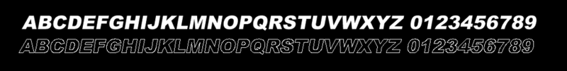

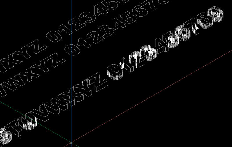

Use Seants text to geom. or TXTEXP a built in explode text.
TXTEXP Arial bold with a Oblique of 10. Then pedit multi, then extrude.
