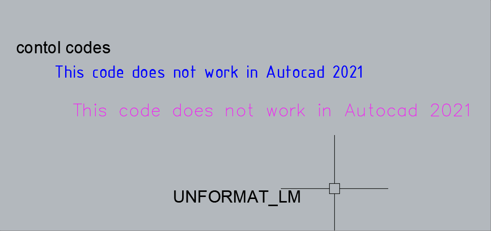

This code does not work in Autocad 2021 (localized version), the selected MText  is being deleted.
How can this be fixed?

9 hours ago, ronjonp said:
You should post a sample drawing.
In Autocad 2015, the code worked correctly, in Autocad 2021,
texts containing control codes are deleted after selection...

It was working OK for me in your sample drawing - I am using 2022 though but would expect any changes in 2021 to be carried through to that.
Looking at the LISP, there is nothing in there to delete any texts, try loading it last in case there is another LISP loaded with the same name as some of the sub routines and try again maybe
Edited by Steven P
Reaction to the Command: (entget ex)
; error: invalid argument type: lentityp nil
I agree with StevenP.
I've tested Lee Mac's code in the 2021 version, and it works fine in your drawing.
It's probably some interference between your loaded Lisp code.
  • Thanks 1

Is there a way to find this intervention?
I have two more codes with this function that don't work...

Thank you all for your advice.
I've tried all the options. It doesn't work…
There is no file UNFORMAT in the startup, I open a new file, download lisp UNFORMAT and nothing changes...
Mysticism?!?
Edited by Nikon
Yes

@GLAVCVS thank you very much!
I run the command buscaDefunsRepets  and I get this message:
FUNCTIONS DEFINED MULTIPLE TIMES:
    Function NAME '*merr*' in:
    C:\Users\Nikon\AppData\Roaming\Autodesk\AutoCAD 2021\R24.0\rus\support\acad2021doc.lsp
    Function NAME '*merrmsg*' in:
    C:\Users\artem\Nikon\AppData\Roaming\Autodesk\AutoCAD 2021\R24.0\rus\support\acad2021doc.lsp
What do I need to do next?

Those functions have nothing to do with your problem.
Your code doesn't work in any drawing?
Edited by GLAVCVS
Yes!
I checked the code in Autocad 2019, it works great!
