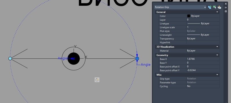

Hello thank you for your reply.
May be I did not explain properly what I want to do. I will post some pictures may be they will help.
On the Block_1.jpg is how the drawing has to look like.
On the Block_2.jpg is the block it self when is edited.
So the script has to change "Angle" and "Angle1" so the so called arrows point to the previous and next block - Block_3.jpg
Ok thats is very similar to what I was talking about, its easy to draw an arrow at a point along a pline, you can do this in a number of ways one of the easiest is to just use "V" rotated + - to to the angle between the points.
Which of these is correct ? You should post a dwg not an image, can then see sizes and offsets from vertices.

Try this:
No error checking, or checking you have selected the correct polyline. Works only of LWPolylines - comment again if you want this to do 3d polylines as well.
I haven't put many notes in this as to how it works, but look through and see if it makes sense.
One thing I noticed is your sample block - to me - was an anonymous block name - which might have been the error you noticed (some technical stuff made it so) - as a fix I copied the block entities and created a new block, calling it "Arrow". You'll need to set your block name in the LISP below to the block you want to use (see (Setq MyBlockName "Arrow") line for what to change).

I made the block again, changed rotations to Angle_1 and Angle_2. Changed in .lsp file too. The script inserts blocks but the angels are not changed. Am am attaching the file, with polyline and inserted block.
That's strange, it worked when I tested it here just now... though Angel_2 was inserted 180 degrees the wrong way - try this fix for that (something to look at later for me for a better fix)

I tested it, its work fine. Only tune that needs is the take care of the first and the last. Both arrows has to point in one direction.
Thank you very much for you time and effort.

I tested it it work perfect. Only thing that is a little bit difficult is selection but I think I can take care of it.
Thank you very mach you help me solve my problem.

              ang2 (+ pi (angle '(0.0 0.0 0.0) (vlax-curve-getFirstDeriv vlaobj (1- nbs))))
            (setq
              ang1
              (if (not (zerop nbs))
                (angle '(0.0 0.0 0.0) (vlax-curve-getFirstDeriv vlaobj nbs))
              ang2 ang1
          (if (and (zerop nbs) (not (zerop (vlax-get vlaobj 'Closed))))
            (setq
              ang1 (angle '(0.0 0.0 0.0) (vlax-curve-getFirstDeriv vlaobj nbs))
              ang2 (+ pi (angle '(0.0 0.0 0.0) (vlax-curve-getFirstDeriv vlaobj (length lst_pt))))
          (if (and (eq (1+ nbs) (length lst_pt)) (not (zerop (vlax-get vlaobj 'Closed))))
            (setq
          (setq
            nbs (1- nbs)
            blk (vla-InsertBlock mspace (vlax-3d-point pto) blkname scl_blk scl_blk scl_blk 0.0)
          (vlax-put blk 'Layer "EL_стълб_НН")
          (vlax-put blk 'Color 3)
          (setq lst (list (cons "Angel_1" ang1) (cons "Angel_2" ang2)))
          (foreach x (vlax-invoke blk 'getdynamicblockproperties)
            (if (setq itm (assoc (vla-get-propertyname x) lst))
              (vla-put-value x (vlax-make-variant (cdr itm) (vlax-variant-type (vla-get-value x))))
  (prin1)
Worked perfect, the scale and the color thing is nice. :)
Thank you very much, for you time and help.
