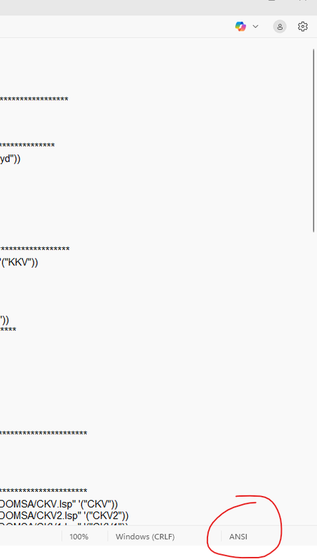

leonucadomi Posted August 26, 2025 Posted August 26, 2025 hello all: I recently changed windows on my computer and some of my routines don't work I have reviewed the notepads and I realize that my routines that had the letter "ñ" have disappeared that symbol and some give me a syntax error. Also in some routines the answer was square meters and the number 2 indicated as a subindex and it also disappeared. I don't know if when I save my routines they are saved in some other format and I know the reason. can someone help me? Quote
SLW210 Posted August 26, 2025 Posted August 26, 2025 Not an AutoCAD issue. What encoding are the files saved with? Font? You are not providing very much to go on. The squared symbol issue would lead me to believe a font issue. Quote
leonucadomi Posted August 26, 2025 Author Posted August 26, 2025 1 minute ago, SLW210 said: Not an AutoCAD issue. What encoding are the files saved with? Font? You are not providing very much to go on. The squared symbol issue would lead me to believe a font issue. My old routines are in ANSI configuration, the problem is that they updated me to Windows 11, if I open and close an lsp it is not modified, the problem happens when I make some modification to the routine, Even though I save the routines as ANSI, Windows automatically saves them as UTF-8 and there are symbols that disappear, for example the letter "Ñ" Quote
leonucadomi Posted August 26, 2025 Author Posted August 26, 2025 1 minute ago, leonucadomi said: My old routines are in ANSI configuration, the problem is that they updated me to Windows 11, if I open and close an lsp it is not modified, the problem happens when I make some modification to the routine, Even though I save the routines as ANSI, Windows automatically saves them as UTF-8 and there are symbols that disappear, for example the letter "Ñ" If I just open and close nothing happens but if I modify my file and save it, even though I use save as ANSI, it still saves it to UTF-8 and deletes characters, and then the routine doesn't work. Quote
Steven P Posted August 26, 2025 Posted August 26, 2025 perhaps not the fix you want, but avoid "ñ", do a find and replace, maybe to 'n' ? I would copy the original file to a temporary or archive folder and make the change to the original - so the LISPs will still work until you can work out how to get the correct characters working. Just checking my default text editor is UTF-8 also What do other text editors do and what encoding do they use? 1 Quote
GLAVCVS Posted August 26, 2025 Posted August 26, 2025 Hi Start by checking which ANSI setting you have on your new OS. Control Panel → Region → Administrative tab → Change system locale button. The system locale should appear in Spanish and the option 'Version beta: Use UTF-8...' should be unchecked. 1 1 Quote

leonucadomi Posted August 26, 2025 Author Posted August 26, 2025 56 minutes ago, GLAVCVS said: I don't think it has anything to do with it. And if it does, it can probably be fixed by configuring the OS. I already found the solution, at least temporarily. what I have to do is the original routine (ansi code), modify it if required, but also add an ansi character, example ;ñ only then it lets me save as in ANSI mode and the characters are no longer deleted or changed. 1 Quote
BIGAL Posted August 27, 2025 Posted August 27, 2025 Notepad ++ can set the save mode it has numerous options including Ansi and UTF-8. 2 1 Quote
