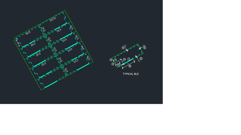

I have been trying to create a lisp which will create a building envelope typical to the attached where offset vary depending on government and /or client requirements.  Generally we draw each envelop individually and then copy and adjust where necessary, but I would like to automate the for use in very large concepts.
The lot boundaries will generally be a closed polyline this is not necessary.
From the attached image and dwg all components B to H are variable and depend on government and client requirements. Component I is variable and subject to variable A which is the lot frontage.
If this frontage and less than 14m then component I is a solid line, if over 14m then it is a broken line.  Component I is subject to engineering earthworks and would require a selection for which side or line to place that line (Built to Boundary Wall).
As stated I would really like to automate the creation of the Building Envelope and all the entered variable are maintained until the lisp is closed.
Hope this explains it enough

it would be great f the offsets could be conditioned so that depending on the frontage the lisp would automatically apply the correct offsets.
The below is an example of offsets as required by a government.  Generally they are not as complex as this table but it gives an idea of what is necessary.

Many years ago Civilcad Civil software we are talking at least 25 years ago had place a house on a lot. You could define various controls such as "Slide on line" so would move a shape based on say a fixed offset from the frontage, you could pick sides and it would show the distance form that side to a boundary, it was smarter than just use a point it would move the distance offset depending on the shape of the lot. Sounds like what you want.
If you were to make a dynamic block that had all those constraints then you could have say a dcl front end change a value and the shape changes.
Its pretty easy to draw that shape based on a rectang, but what if its not rectangular ?
thanks.  I will see how I go creating the dynamic block.  It does sound like what I want
