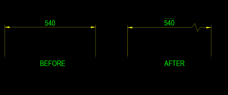

hello all:
There are dimensions I need to do this to.
I have a routine to do this
It would be possible to do everything in a single selection
I mean select the dimension and place the break and the line over the text
I await comments and here I put the code, thank you

Hi
Do you want to place the 'jog', indicating its location in each case, or in a predetermined location?
To indicate the 'jog' position 1 to 1, insert this code after the clause ((= "DIMENSION"... (entget e) ))))
      (if (not (tblsearch "APPID" "ACAD_DSTYLE_DIMJAG_POSITION"))
	    (regapp "ACAD_DSTYLE_DIMJAG_POSITION")
	  (if (setq pt (getpoint "\nJOG: Pick a point on the DIMENSION line"))
	    (entmod (append (entget e) (list (list -3 (list "ACAD_DSTYLE_DIMJAG_POSITION" '(1070 . 387) '(1070 . 3) '(1070 . 389) (cons 1010 pt))))))

image.png.a784687f92c1e96ca39d46156be96d79.png something is wrong
4 hours ago, GLAVCVS said:
Hi
a default location near any arrow
	  (setq p1 (cdr (assoc 13 le))
		p2 (cdr (assoc 14 le))
		pIns (polar (cdr (assoc 10 le)) (angle p2 p1) (* (distance p1 p2) 0.8))
		x (entmod (append (entget e) (list (list -3 (list "ACAD_DSTYLE_DIMJAG_POSITION" '(1070 . 387) '(1070 . 3) '(1070 . 389) (cons 1010 pIns))))))
	  (if (= (vla-get-textoverride o) "")
	    (vla-put-textoverride o "\\O<>")
	      (strcat "\\O"
		      (vl-string-subst "" ""
			(vl-string-subst "" "\\O" (vla-get-textoverride o))
  (command "._undo" "_end")
  (setvar "cmdecho" 1)
And this is the small variation that best fits what @leonucadomi is asking for, I think.
With the peculiarity that the "jog" will be placed where the selection is made with the pickbox.
; Original by RonJonP, edited by P. Kenewell and GLAVCVS
(defun c:ltx (/ e o s le to l)
  (setvar "cmdecho" 0)
  (command "._undo" "_be")
  (while (and (setq e (car (setq l (entsel "\rSelect a TEXT, MTEXT or DIMENSION...")))) (wcmatch (cdr (assoc 0 (setq le (entget e)))) "*TEXT,DIMENSION"))
    (setq o (vlax-ename->vla-object e))
    (cond
      ((= "TEXT" (setq to (cdr (assoc 0 le))))
       (vla-put-textstring o
	 (strcat "%%O"
		   (vl-string-subst "" "%%O" (vla-get-textstring o))
      ((= "MTEXT" to)
	 (strcat "\\O"
		   (vl-string-subst "" "\\O" (vla-get-textstring o))
      ((= "DIMENSION" to)
       (entmod (append le (list (list -3 (list "ACAD_DSTYLE_DIMJAG_POSITION" '(1070 . 387) '(1070 . 3) '(1070 . 389) (cons 1010 (cadr l)))))))
	   (strcat "\\O"
Edited by GLAVCVS
  • Thanks 1
This will do what you want by selecting multiple objects in the selection set.
(defun c:ltx (/ o s le to p1 p2 pIns)
  (if (setq s (ssget ":L" '((0 . "*TEXT,DIMENSION"))))
    (foreach e (vl-remove-if 'listp (mapcar 'cadr (ssnamex s)))
      (cond
         ((= "TEXT" (setq to (cdr (assoc 0 (setq le (entget e))))))
               (strcat "%%O"
         ((= "MTEXT" to)
               (strcat "\\O"
         ((= "DIMENSION" to)
	      (strcat "\\O"
I love this, it's excellent, thank you
