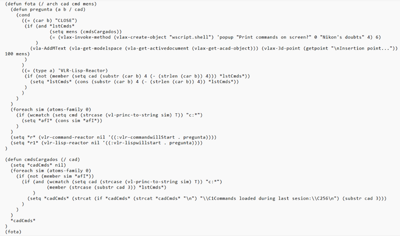

I need you to explain a little more.
Did you use multiple Lisp commands or just load files?
Take a screenshot of the code you pasted into the "acad2021Doc.lsp" file.
I  load programs and use them.

So, Nikon, the problem is that you must have opened the same drawing several times in the same AutoCAD session, and several prompts have accumulated, repeating the request several times.
That problem shouldn't occur anymore with this new code.
Also, you'll be able to see the text inserted before confirming the closing of the drawing.
Simply replace the "fota" function
in your "acad2021Doc.lsp" with this new one.
