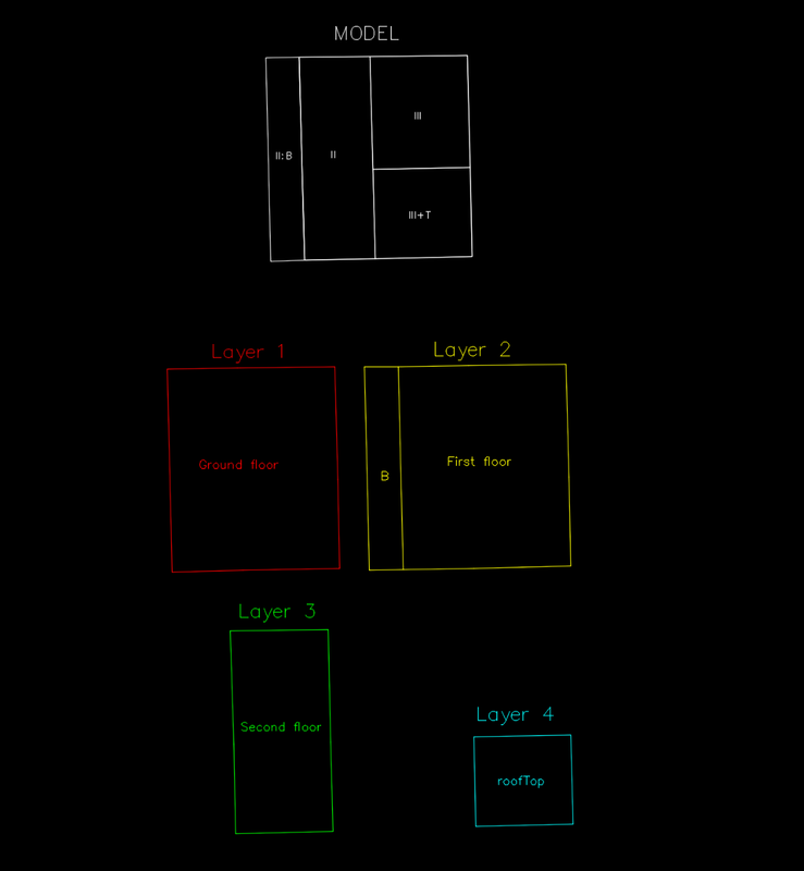

PGia Posted October 7 Posted October 7 Hi I’m wondering if this topic has been discussed in this forum before. In simplified terms, the issue is this: if you have a 2D perimeter with inner sub-perimeters, and within each of them there’s a label indicating the number of floors rising above that perimeter — would it be possible to create, for each floor, the corresponding perimeters on specific layers for each one? Does anyone have any idea how to approach this? Quote
devitg Posted October 7 Posted October 7 3 hours ago, PGia said: Hi I’m wondering if this topic has been discussed in this forum before. In simplified terms, the issue is this: if you have a 2D perimeter with inner sub-perimeters, and within each of them there’s a label indicating the number of floors rising above that perimeter — would it be possible to create, for each floor, the corresponding perimeters on specific layers for each one? Does anyone have any idea how to approach this? @PGia please upload your sample.dwg, before and after Quote
CyberAngel Posted October 7 Posted October 7 It sounds like some fairly simple AutoLISP code would handle this. You'd have to specify where to get the data, how to format it, and where to put it. For instance, the "label" including the number of floors: is that a block, a piece of text, an annotation in Revit, or something else? Is the number part of a code with letters and numbers, or is it just one number? Would all the "perimeters" go to the same height or to different heights? What format would the layer names have, and is the floor number the only variable? There are a lot of blanks to fill in here. Quote
PGia Posted October 7 Author Posted October 7 Hi. A simple example. The main label is always a Roman numeral followed by a : or + to indicate, respectively, a floor plan with a particular feature or a number of volumes with another additional element above it. There are many more possible combinations, but I'll stick with a simple example. ctePns.dwg Quote
PGia Posted October 7 Author Posted October 7 To avoid confusion: I've separated each resulting perimeter from the model drawing to show it in this example. In reality, each perimeter logically overlaps the others. Quote

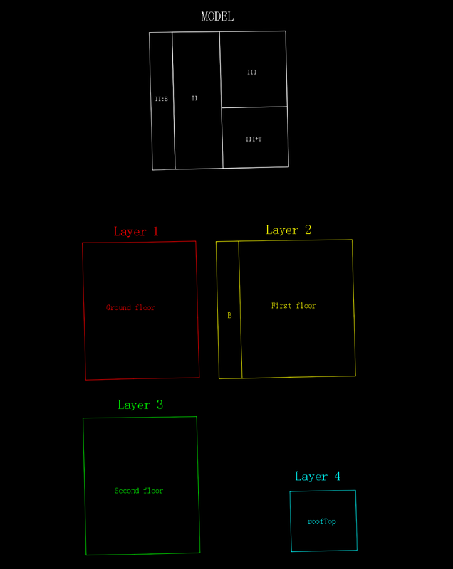

GLAVCVS Posted October 8 Posted October 8 8 hours ago, PGia said: Hi. A simple example. The main label is always a Roman numeral followed by a : or + to indicate, respectively, a floor plan with a particular feature or a number of volumes with another additional element above it. There are many more possible combinations, but I'll stick with a simple example. ctePns.dwg 927.63 kB · 3 downloads Hi @PGia I'm not sure I understand your example drawing correctly. But... isn't it possible that it's incorrect on the second floor? Quote
PGia Posted October 9 Author Posted October 9 On 10/8/2025 at 8:42 AM, GLAVCVS said: Hi @PGia I'm not sure I understand your example drawing correctly. But... isn't it possible that it's incorrect on the second floor? Yes, that's true! I was wrong. I think you understood the tag syntax very well. I'm attaching an image of what the second floor should actually look like. Quote
GLAVCVS Posted October 9 Posted October 9 If I understand correctly, you can't do this with standard AutoCAD tools. You need to associate each label with its perimeter and its neighboring boundary. To do this, you'll need to break each perimeter down into individual polylines. Each perimeter section shared by two labels must be a separate polyline. Start by figuring out how to achieve this. 1 Quote
PGia Posted October 9 Author Posted October 9 7 hours ago, GLAVCVS said: If I understand correctly, you can't do this with standard AutoCAD tools. You need to associate each label with its perimeter and its neighboring boundary. To do this, you'll need to break each perimeter down into individual polylines. Each perimeter section shared by two labels must be a separate polyline. Start by figuring out how to achieve this. I'll investigate. Any suggestions? Quote
