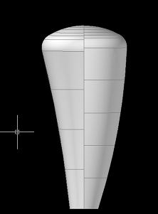

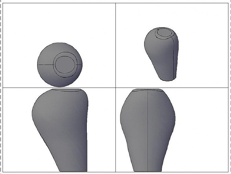

MikeP Posted April 23, 2009 Posted April 23, 2009 Im trying to create a car shifter knob. its not a uniform shape. here is what the iso and the side view looks looks like. I created these shapes by making half of it flat in 2d then revolving it 180°. then i put them back to back. but as you can see them do not mesh correctly. how can I create these shapes so they can mesh nicer. Im trying to learn how to create complex 3d objects, but obviously im not very good at it. Are there any tutorials where I can learn some things. Quote

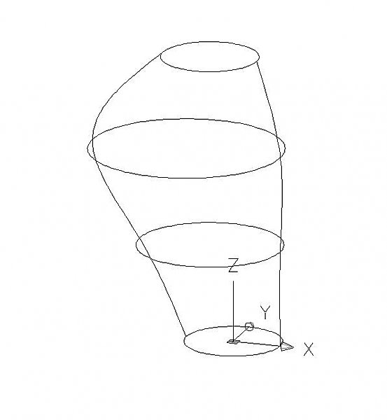

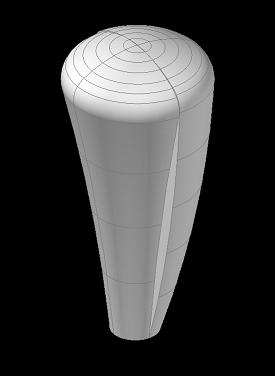

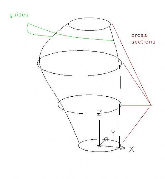

shift1313 Posted April 24, 2009 Posted April 24, 2009 Did you try what i said about drawing 4 circles and the coordinates i gave you and then selecting those circles in order for the loft? There should be nothing else to select. alright here are a bunch of screen shots for you. The first couple have some"guides" drawing but i only used the circles for the loft. The last two pics show the spline guides and the loft using guides. in both cases i performed a fillet on the top edge after the loft was complete. You dont need to if you draw your cross sections and guides how you want. In this case i only used two guides drawing from the side view but you can have more. You need to make sure your guides hit each profile. The path option is a little different but in this case you can probably drive the entire shape with 3 cross sections and finish it off with fillets. Quote
MikeP Posted April 29, 2009 Author Posted April 29, 2009 nice got it working. but how do i know use the paths and quides? Quote

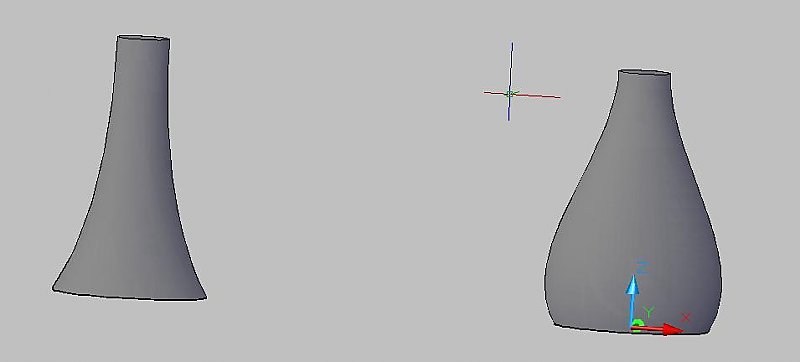

shift1313 Posted April 30, 2009 Posted April 30, 2009 It really depends on the shape you are going for. I think the best advice is use the least amount of guides/paths/cross sections as you can to achieve the shape. When you are lofting you can play with the options in the dialog box and drive how it enters/exits each curve without using guides. here is an example for you. my cross sections are circles at the start/end. i loft with setting my starting draft angle to 120degrees(how it leaves the first cross section), then using a draft of 60degrees from the first cross section for the image on the right. Quote
