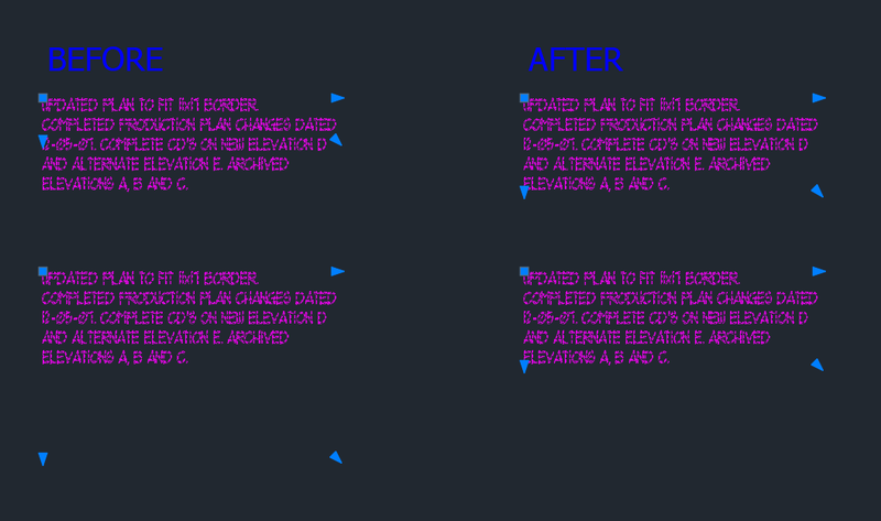

Hello all. I'm looking for a Lisp that enables me to just select an MTEXT -or Just apply it to the entire plan- And it automatically redefines MTEXT width and Height to be tight around the text as shown in the picture. Please let me know if you have any questions.
Thank you! But my goal is a lisp that would automatically set up the width and height to match the text shown without any input from me.
Here is one I did a while back for the WIDTH only. (I'll see if I can add the height as well.)
NOTE: This doesn't work well with Annotative MTEXT, and it will not work if the columns are set to "dynamic"; must be set to "No Columns". (see screenshot).

If someone can figure our a way to scale properly with annotative text and turn off columns programmatically, then it would be good to add.

@Someone_Pro
I found this at AutoCAD Tips: https://autocadtips1.com/2011/08/13/autolisp-text-box-width/
Command: TXTBOXWIDTH

I think this one does dynamic columns as well:
mtxtWdtHt

There is also Lee Macs Box Text function for another option...
