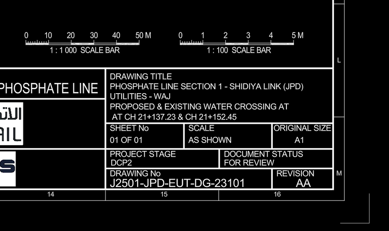

dear all i have text as PROPOSED & EXISTING  WATER CROSSING AT CH 81+137.23 & CH 21+152.45 and i want to take part of Thes text as name of title CH 81+137.23 & CH 21
i think as field but i can't doit can you help me
If I understand the question, you want to use the stationing as part of a text label and as part of a title block.
One way to do that is to define a custom property as one of your drawing properties. Set it to that text. Include the field in your text and in your title block. When you change the property, the field automatically updates with the new value.

ABOVE IS NAME FOR LAYOUT
IN FRAME DRAWINGS TITEL I WANT TO MAKE THESE FIELD WHEN CHANE THE LAYOUT NAME AUTOMATIC CHAHNGE IN FRAME
dear its not big problem i know but every time edit name layout we must go to Titel frame and copy modified or edit and sometime forget edit so i need its field thank for all experts in these site

dear all these my problem
every time i when modify station text must go for all text in red color and modified same station text so i think if i make afield for one to all text when modify in one text automatic change in all thanks again   i applodt file for one of these dwg1FIELD-TEXT.dwg1FIELD-TEXT.dwg
You could make them blocks, update one, the rest update.
The best IMO would be, as mentioned by CyberAngel, custom properties that can be referenced by fields.
You could also use LISP, etc., but since you mentioned fields, the custom properties and fields might be easier for you.
